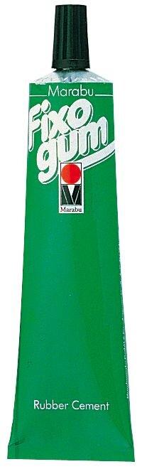

I am not using a spray, but the obligatory Rubber cement Fixo-Gum by marabu - can be removed easily afterwards without any residues - with a spray to spray all areas around and not only the area you want to ....
Yes - these rubber cements are not very cheap, but you do not need much - so I have my tube already since years and still not empty.
So it is an investement for more than one model ....
The last jar I bought,about five years ago, had a shelf live of about 6 months then it dried up. Not sure why, possibly a bad batch. I normally use those glue sticks that kids in school use.
