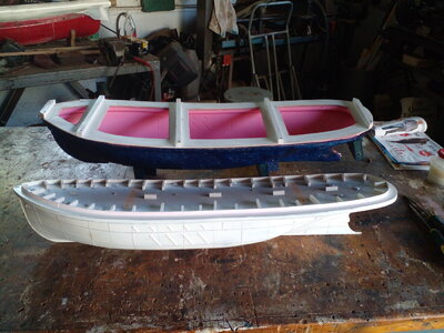

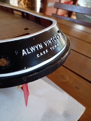

Having finished all components for the "Alwyn Vintcent" 1:32 Scale Tug Kit I'm now proof building the "kit" making sure everything fits.
Model is detailed scale replica of actual tug (currently being restored in Villiersdorp, South Africa.)

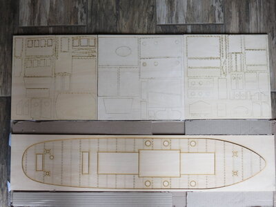

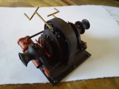

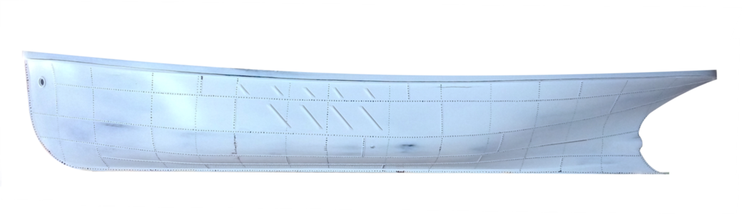

Kit I've put together includes a full set of plans and reference photographs, detailed Fibre-Glass Hull, laser cut 3mm birch ply structure elements, laser etched and cut deck and all fittings (designed from original drawings and photos and 3D Resin printed).

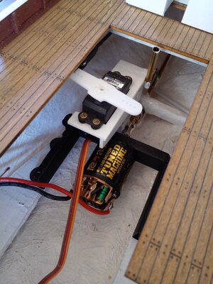

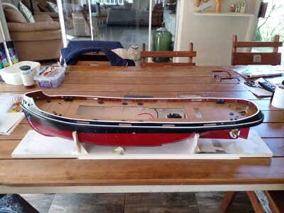

Have completed the hull, including raised lettering, installation of deck and gunwales and installation of power-train.

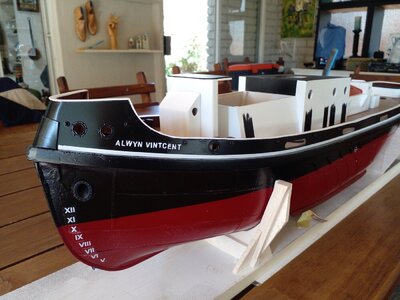

Now working on superstructure
