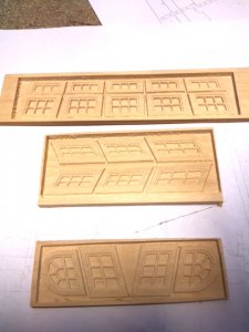

Just looking through my kit fittings and these stern galley windows are CNC cut from boxwood.
I don't like my chances of cutting out the window frames with a Xacto knife as I can guarantee some of the glazing beads will break away.
I have been following another Chinese build log of the same model and the same problem happened. Just wondering if someone can post a link for 1/48 scale plastic window frames that might do the job ?

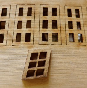

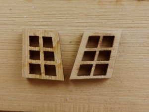

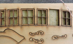

here are some examples of stern windows I cut, at one time i had access to a small laser the one I use now is way to powerful and just fried this type of delicate work, the difference from 100 watt laser to a 800 watt.
you can cut them heavy or adjust the drawing to cut very fine.
One thing to keep in mind is you will either have to paint the window frames OR clean off the char. Needless to say the finer you laser cut the frames the more chance of them breaking. I solved the problem by using my mini air brush sand blaster and just blew away the char you can see to the left on the second photo where I hit it with the sand blaster. If you are going to paint the windows then no point in using wood use plastic far stronger.

I used to have the Boss laser cutter, 80 watt, and the lowest power I could go and still cut wood was 10% of full power. By varying the power and speed, there wasn't much i couldn't cut. I cut windows, even blocks that are built in layers.
