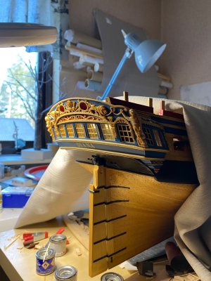

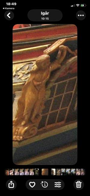

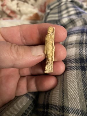

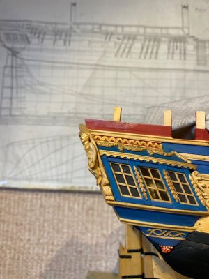

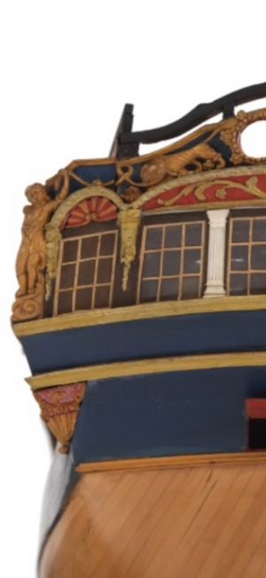

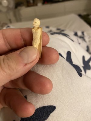

Trying to get details and get her a smothered finish and after that try to get one more as close as possible to the other side.
Then the big question if I must take a chisel to make place on the quarter pice? I will see how to do.

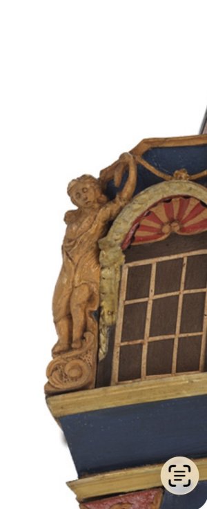

On another model from NMM with Id:SLR0643 you can se on the port side the figure missing compared to starboard side.
I looks brutal really but it’s wood and can always be replaced.
I’m not expert in carving and try to get something acceptable for this model.

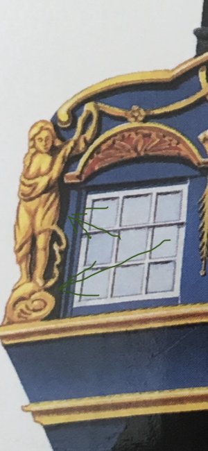

If you looking at the colorful backfiring of D whites anatomy of Diana you can se a shadow right to figure,I think it’s cutting out for the figure to get the position on the quarter pice.
My thoughts is,that in shipyards where they were built they have to replace things when they sailed home from a battle the have made quarter pieces of different types and sizes,some have relief carvings,others have figures carved,it should be easy to change and replace.
This models was often prototypes of the real ship and I think it’s not just the craftsman who made this work? It was how the build the real thing?
It should be quick and economic at the end of 18th century.IMG_4949.jpegIMG_4948.jpegIMG_4930.jpegIMG_4926.jpegIMG_4927.jpegIMG_4912.jpeg

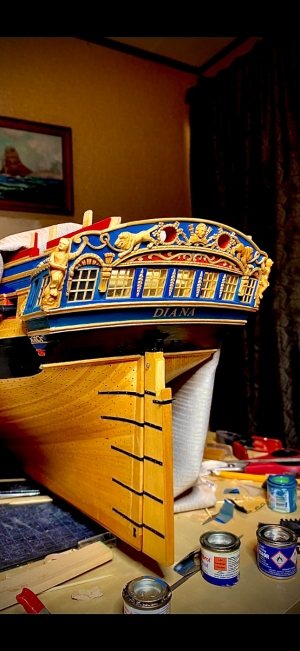

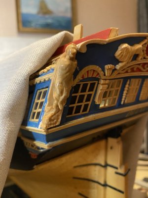

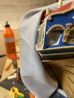

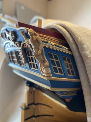

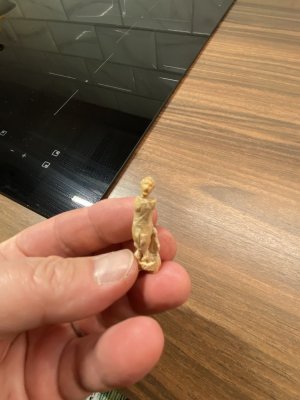

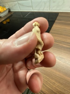

Coming along a little bit how my thoughts about the figures in the corner of the quarter gallery pice.
Now the figure is more a part of the stern rather than just a flat figure glued to the surface of the stern.

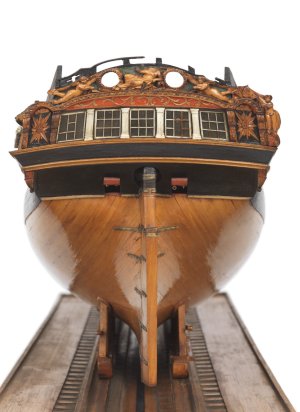

A lot of xtra work of course but I think the overall impression is better.The picture of the stern from the NMM Greenwich beautiful model of the Diana you clearly can se that quarter gallery pice is a separate pice of wood.
Lot of more work with arms and the leash to the lions etc.
Take my time to make one of the most tricky part of the stern-decoration on the Diana is the rope going through what I think should be some type iron hinge bolted I taffrail.
Really tricky part to get the same on the other side.

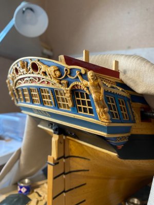

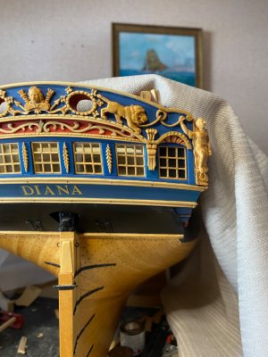

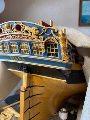

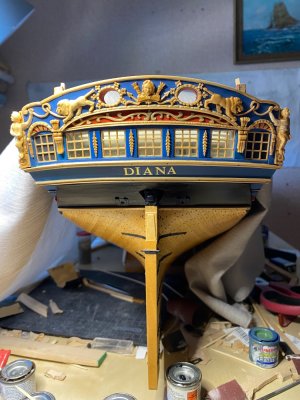

After my wife and I cleaned up and reorganized the small workshop we did some work together.
She goes on with her Mississippi steamboat and I struggling with my Diana.

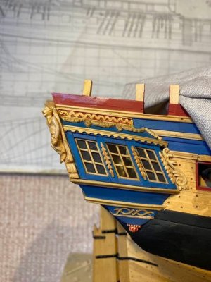

One more figure port side almost done with arms and the rope between the lions.
Some pilasters between the figure and quarter false lights are done to.
Everything takes time to do.
