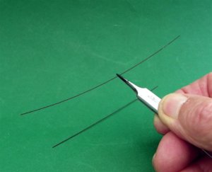

Use copper wire instead. Just stretch it slightly and it will go straight - Here are twpo pieces of stretched copper wire. I have purposly put a curve in the one held in the tweezers. You can do the same with brass, but it needs more effort. Put one end in a vice, and grab the other end with a large pair of pliers and heave on it. - It is still fairly easy with 0.5mm brass -
