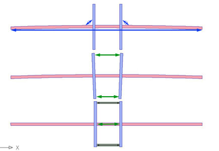

Hallo @Jahno
i realize the original post was back in May but i thought i might post a solution to a warped profile piece or center keel for anyone who encounters the problem.
you can force it straight by adding supports. i do not suggest wetting plywood.
top drawing, if the center piece has a warp what i do is to glue in the two center bulkheads or glue in two bulkheads skipping one in between. Glue these at 90 degrees to the center piece regardless of the overall warp
the next drawing shows the two bulkheads will not be perpendicular to one another caused by the center piece being warped.
bottom drawing, take a measurement from the center of the two bulkheads and cut two pieces of wood the same length, wedge these between the two bulkheads. Because the two bulkheads are glued to the center keel it will force the center keel straight. Now you can build off the two center pieces doing the same thing with pieces of scrap wood between the bulkheads.
