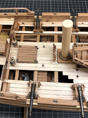

On the Discovery1789 the gunports come right up to the caprail. This means that there is nowhere for the string in the waist. Do you think that the caprail may have been made a little more robust in order to take some load or would they just ignore it? Sorry for all the questions, they just pop up:)

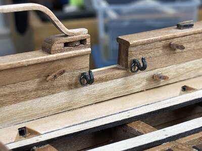

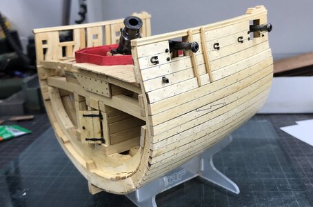

If yes - the bolts for the tackles were going trough the frame top timbers and were fixed there. So in my opinion there were no additional forces transfered to the caprail
Take a look at my Coureur - here the caprail was interrupted at the gunports

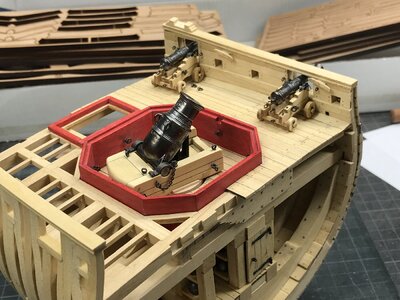

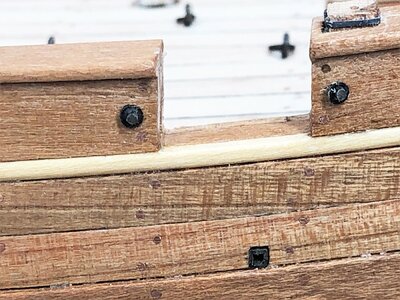

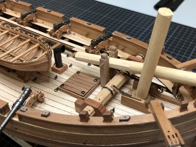

or The Granado where only the caprail is going over the gunports
The Discovery is like the Granado. The loads I'm referring to are the longitudinal loads on the ship to help minimize sagging and hogging. Goodwin mentions it on pg 43 of English Man of War.
