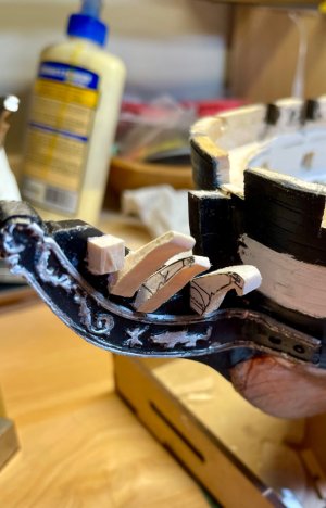

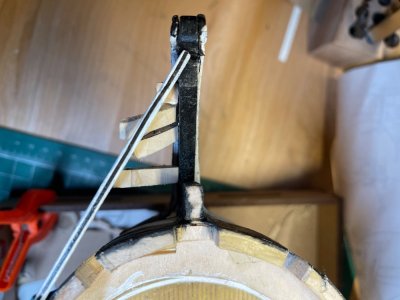

I’m facing a dilemma with the bowhead assembly on my Bluejacket Constitution. It requires a series of supports (I think they are called cheeks) that flare out from the stem. I have been unable to find images of these pieces anywhere and I’m reluctant to glue the cheeks until I’m sure of the technique.
Anyone who has built this model knows the instructions and diagrams and plans leave a lot out, and can be confusing.
Does anyone have any experience with this model and do you have pics?
Any help is welcome.

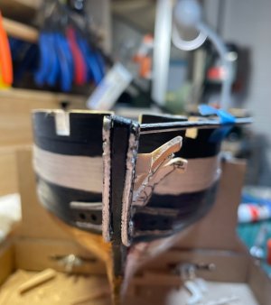

I have attached pics of how I think the cheeks are placed, but I could use some help. They are temporarily attached. If this is the method, I’ll tidy everything up.
Thanks
Jim
I would recommend that you get the book "Anatomy of the Ship: Constitution" You can still get it at a reasonable price and there are lots of pictures and drawings in there. It is a wonderful source for information.
Thanks Jeff,
I have the book and used the bow and head diagrams, along with the plans that came with the ship. You’re right about Marquardt being a good source.
So I think my concept of the framing is close. I’m just lacking some detail and looking for help before I squirt any glue.
Jim
Have you contacted Kate Monea or Carl Herzog of the curator staff at the Constitution Museum? Maybe they can steer you to getting a copy of the Joshua Humphreys drawings. The head timbers look oversized and the wrong shape. It is easier to install the two cheeks, the eeking rail and cathead supporter, and main rail, then shape the head timbers to fit if the exact drawings are not included. The covering boards are easy as they are only thin pieces that can be bent to shape.

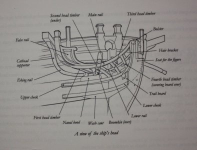

The below is not the Constitution, but may be helpful when the names of the various parts. The drawing below is from The Fully Framed Model, volume 2, by David Antscherl.

You are more than welcome. It is still not in the least bit easy, and you may wind up making pieces more than one time, but it works.

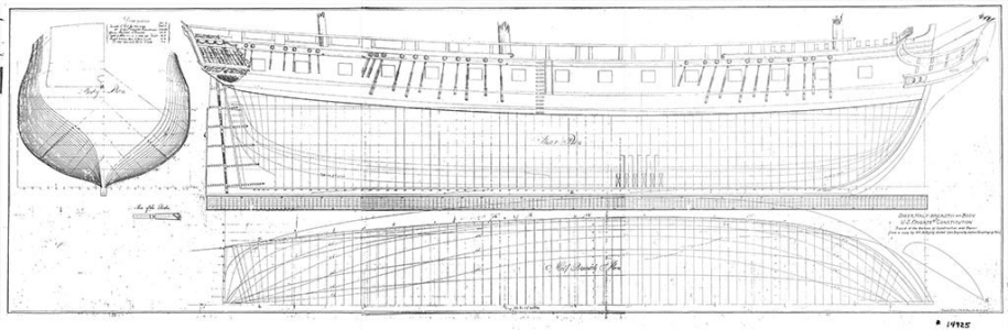

Roger, We need rain where I live, so thank you. :) It was my understanding that the drawing I posted was from Humphreys. I really have no knowledge about her then or today so ask, is the drawing not from Humphreys or am I misreading your post? I good read may be the following from the museum.

Allan, Sorry if my post was confusing. The drawing that you posted is Constitution’s original appearance. It matches the National Archives drawing in the Govt’s Barbary Wars book.
The problem is that she has been modified any times during her long life, especially her head structure. The kit builds this modified structure not that shown on Humphries drawing.
roger
