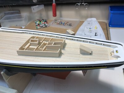

My Bluenose hull is complete, and I am now starting on the deck structures. I have been following the suburban ship modeller blog, and it has been extremely helpful. I urge anyone building the Bluenose to have a look at the site.View attachment 196492
It looks like you have taken the cabin to a new level with the interior bulkheads. Are you going to do it with the cabin doors open to be able to look in/down? I cut off the mainrail "seat" over that buffer as it does not show like the kit in my Bluenose II views which are said to be the same as the original schooner. That main buffer will be on a block fully open on top on mine, right or wrong. Still need to remake my main rail if when the width is corrected and the joints have open gaps. Yours look very well done. Rich (PT-2)
I thought it would be interesting to leave the cabin doors open.
I think that they must swing out. I wonder if there were any latches securing them in that position? Must have been. Maybe we can find something in videos of Bluenose II. How are you going to do a ladder down below deck? You are providing a good build and series of items for me to consider that I may not have before but can see your results. Rich (PT-2)
Not sure about the doors yet. It’s all about my energy.
