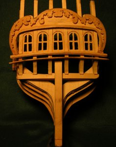

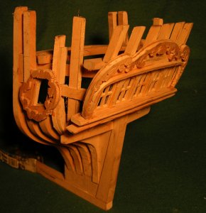

At one time a friend of mine had a 50 watt laser and we were testing 3D carving with a 2D laser. Before we could perfect the idea he got into a nasty separation and had to sell much of his machines including the laser. The laser I use now is way to powerful and I can not dial it down enough to do such delicate work.
The concept was to create a stern X section kit where basic carvings are provided and an instruction log on carving would be created. It was geared more to teaching and learning to do a basic carving. to give the student a fair chance on success a blank would be provided.

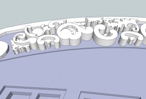

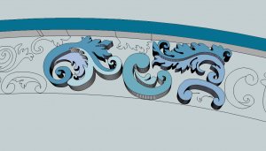

the process begins with CAD files

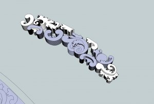

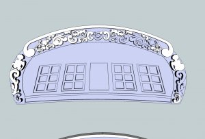

the 2D cad file is then converted to a 3D file

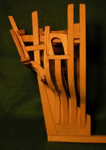

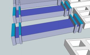

the idea was to create color zones and the laser dialed in to etch each zone at a different depth
this could be applied to other elements besides carvings
problems we were having was if you look at the leaf patterns and the space was less that .012 the beam cut into the pattern edge next to it so trying this at a scale of 1:48 was to small. A X stern section had to be twice the scale minimum. Another issue was the char along the sides was very difficult to remove in such a tight space. Using an air brush size sand blaster solved that problem.
What the student would do is round out the edges between layers and add detail.

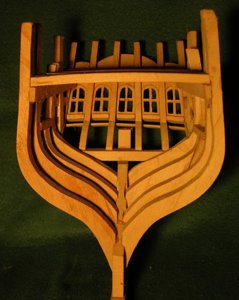

realizing the question was wood suitable for laser cutting and letting it drift from that question here is a rough and I mean ROUGH concept of the above idea.
the project was abandoned when my buddy got raked over the coals and the laser was gone. and I never tried to refine it so the idea is wide open for anyone wanting to give it a go. I would be more that happy to add my CAD work
