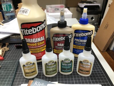

I really can fully recommend the glues from tidebond - best quality and never a problem with clogged nozzle
The four smaller bottles in the front - and btw extremely strong joints when you fix wood to wood

Thank you Lucius. Have always used Titebond back row. Didn’t know that they made CA. Will buy some. Does their CA work with metal on wood?

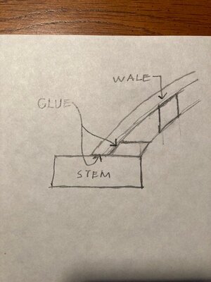

I use titebond II on my builds but have noticed during my build that the wale attachment at the stem and joining timber pop loose.
What glue would you suggest for this connection .

Rick,
Probably superfluous, but did you form the wale to match the curvature?
Too much tension on the bond and you're in trouble.
