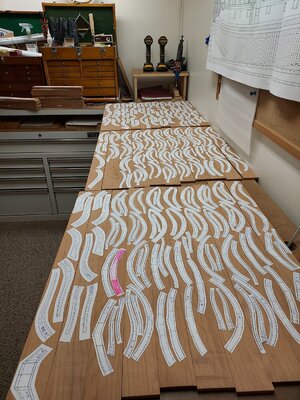

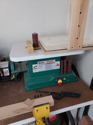

Hello everyone I just wanted to give an update on my build log , I now have all my frame patterns glued down & will be moving on to cutting them out on bandsaw & sanding closer with spindle sander, I would have to say that I am really enjoying this build so far , I will try to keep updating the build process step by step, it may be awhile until next step, lol
These are a lot of frame elements - your bandsaw will get hot, so I hope you have a spare saw-band ....
