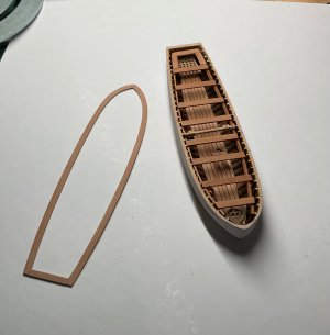

Trying to get at it again after a lull of a few weeks.
Quite a while back I cut lifts from pear stock using the basic basswood sheet shapes from the Syren kit as templates - (https://shipsofscale.com/sosforums/threads/syren-1803-1-64-model-shipways.7779/page-16#post-276064). I wanted to try my hand at this method of longboat construction even though it is more work intensive than, say, building a Vanguard type of longboat kit. The kit designer went to great lengths to provide a comprehensive manual for the Syren. So I thought I’d at least try to construct the longboat as shown in his instructions.
Progress so far includes thinning the boat hull to a suitable thickness, fitting a multitude of fiddly ribs, adding pear floor boards, spaced pear thwarts, a tiny iron mast bracket (brass), a carved and turned pear windlass, sized and reduced gratings for’d and aft, initial work on the pear cap rail, and so on. There’s lots more to come, of course, and I don’t think there’s much in the boat now from the supplied kit parts. However, I continue to enjoy working with pear so that kind of influenced my decision to “bash the boat”. A photo to show limited progress so far before I add more parts. I’m looking more for aesthetics at this stage of the Syren build than technical and historical accuracy. I can hear the intakes of breath even now ! ROTF. But all that can come later with more experience, knowledge and of course time.
If this turns out crappy looking I have a Vanguard boat kit on standby :) or I’ll try an “Allan boat” @AllanKP69 but I’ll see where my “bash the boat” takes me first :)

To me, the planking is one of the most difficult things to achieve at our scales as the planks, according to the scantlings from David Steel, were no more than about 0.75" to 1.25" thick depending on the type and size boat.
Thanks for your input Allan, your experience is always well appreciated. I took the hull thickness down to 9/128” (about 1.75mm) on average. Way over scale but I was concerned any thinner and I’d struggle keeping the hull intact. The cap rail should “hide” the apparent thickness, I hope. As I mentioned in my post I’ll keep my options open and replace this “dugout” ;) with something more appealing later on, if necessary.
Don't doubt yourself, Roger. This boat is progressing beautifully!
Thanks Paul, you’re a good man. Yes, some doubts are creeping in but I’m determined to see what’s achievable with this method. Good thing is it can easily be replaced at some future date if I lash it down instead of glueing it to the gallows bitts. Though the name “gallows bitts” may indicate it’s future once mounted ROTF.
