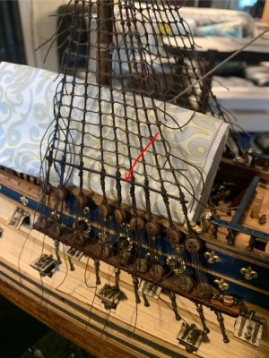

Hello... the second model kit I am trying to make is Golden Hind.How tight should the threads be?If the threads are loose, how can I tighten them without unraveling them?

Make the shroud lines taut with a tad of stretch. It doesn't take much, and you can judge when they are tight enough. The trick is to make the tightness as close as you can by feel to the other shrouds. Install the shrouds in pairs, one port and one starboard, so the lines don't bend the mast to one side. As you add more shrouds, the force on the mast increases, so that's why it is important to balance the line tensions, and NOT rig all the shrouds on just one side of the ship.
The lanyards between the deadeyes should not be slack, but taut as well. As you add shrouds, try to keep the upper deadeyes at the same vertical height as the other deadeyes. If the shrouds are taut, there is enough spring each shroud to allow you to adjust tension of the lanyards between the deadeyes to adjust and set the vertical position of the upper deadeye.
The shrouds on your foremast look perfect!

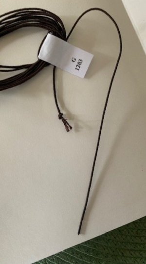

The attachments may also be helpfull to you.The ratline-stiks improve the rigidness and homogenity of the shrouds and ratlines.mostly wood sticks covered with rope or yarn.
By my model i made them using a thick yarn (0.8-1.2 mm ) treatead with CA glue in a straight , stretched out position

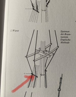

Just as an FYI, according to James Lees in The Masting and Rigging of English Ships of War page 42, these stiffeners were called sheer poles on English ships and were usually 2 inch diameter iron bars lashed on the outboard side of the shrouds just above the deadeyes and came into use in the mid 19th century. It may have been different on ships of other nations.
Supplementary info to Allan's thread: The so called sheer poles (in german language ''wurst '' meaning salami) are also used in 16th and 17th centuries according to the attached Handbuch der Modelbauer page 300, either as a single in back or frontside of the shrouds or as in a sandwich form doubled.
