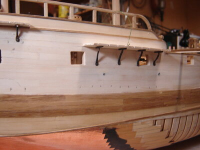

I'm attaching the channels to the Discovery1789. Steel says that there are iron tees under the channels to reinforce them. Ships Repository says wooden knees on the top. When I look at the drawings in Mondfeld he shows both tees and knees. The drawings I have don't show either. I'm thinking that Mondfeld showed both just as a convenience for the book but I'm not sure. I've already installed the tees but I'm unsure of whether to install the knees also. I'm assuming that the iron tees superseded the wooden knees. Any help would be appreciated :)

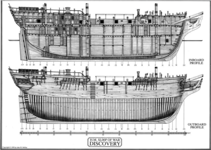

John McKay's drawing of HMS Discovery do not show knee supports for the channels either above or below. That doesn't mean conclusively that neither were there, but it does mean that we should dig for more sources until we find one that does show them, and then study carefully where they are, how big they are, what their shape is, and what they are made of before deciding what put on or leave off of the model.

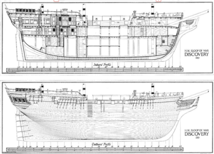

Another drawing I found. . .
Yet another drawing... still don't see any knees for the channels. . .Did Steel say that knee were present specifically on the Discovery?

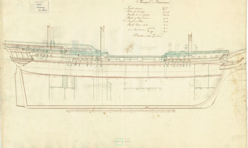

No Steel didn't say specifically, I refer to him, well actually Alan Yedlinsky's book is where I was looking. I have all those drawings and all that the RMG has and I can't see any sign of braces or knees. So I'm stuck trying to second guess even more things on this ship. I was warned when I started that this was not a good choice because there wasn't enough info available. I've looked everywhere I can think of and there is nothing about the Discovery1789. I've read George Vancouver's log of the trip a half dozen times (not an easy task) and there is little or nothing about the ship Anyway, all I can do in a lot of things is to look at what other ships of the period were doing. This is where I have to fall back on you guys that have seen lots of ships. I'm hoping for someone to say, "Oh, I"m working on the such and such built in 1790 and it had both tees and knees." Things like that. Anyway, enough whining :) Have you ever seen a ship with both tees and knees?

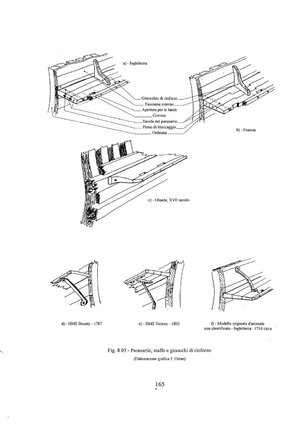

Frank, if you look at the picture I posted the tees are the little black things under the channels. The knees are not shown but they would be kind of the wooden equivalent on top of the channels.
My suggestion is to leave as you have currently modeled…just the tees under the channels. I have seen both but not together and the knees above the channels on very early ships of the late 1500s and 1600s.

That was my plan and then I saw the picture in Mondfeld's book and it made me wonder. It's also a lot easier, those tiny little knees were looking rather daunting. :)
Yup that's what I'm looking for Frank. Have you ever seen a ship with both wooden knees and iron tees? It's also looking like I should have used the same brace as the Bounty. It was built 3 years before the Discovery. Mine are like the Victory which was 13 years after. The Bounty braces would have been a lot easier to make too. The picture of the channel with no braces was Dutch 17th century so I can put that on a back burner for now
