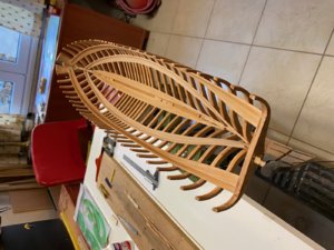

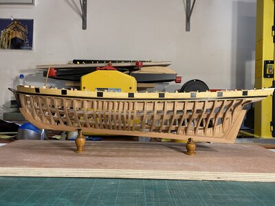

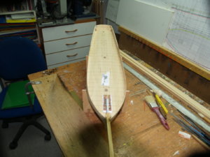

Nevertheless we have decided to build 2 models of the same vessel. One is the shipyard model with a partially open hull and rigging without
sails and the other is a fully rigged and colored model appearing as she sailed during the war.
I already posted the only existing painting of Terpsichore in my presentation when I joined SOS but I post it here below to have
the entire subject under the same thread.
You will also see the first completed drawing of the hull belonging to the "Monographie" to be printed with the presentation of the 2 models
somewhere in 2021.
Below, also I show the first photos of the building of both models.
George and I will be glad to read your commentsA. Roux Gravure.jpgP4278273.JPGIMG_3246.jpg

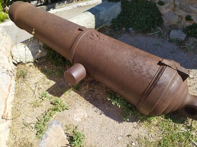

We found in Thomas Gordon's "History of the Greek Revolution" the following text on page 487:
"Their junction with the piratical force con
stituted a body of 4000 men , who were put under the
orders of Yani Khalis, assisted by eight influential cap
tains, and destined to kindle an insurrection in the
eastern districts , whence it was sure to spread to the
western provinces. One day 's voyage wafted them to
the roads of St Nicholas, in the canton of Mirabella ,
where they landed (December the 2d ), and , pushing
detachments towards Girapetra and Spinalunga , slaughtered all the Mussulmans they met with .
The commandant of Mirabel retreating into a tower with 160
Turks, they invested and battered it with a 48 lb . carronade ,
brought ashore from Tombazi's schooner , theTerpsichore."
Our question is the following:
After numerous hours of research in our documents, we found no carronade of 48lb!!!!!
We found either 42 or 68.
As we said in our introduction, other documents state a 48lb gun, not a carronade...
Since we know that guns of that caliber were dismissed from naval use due to their weight
(over 5 tons) in early 1700, it is obvious that the use of a carronade (68 lb =3 tons) would have been far more
suitable for such a small vessel.
We also definitely know that the 12lb guns were bought from France and we further know
that Emmanuel Tombazis hired a french artillery officer for advice on arming both his ships
(Terpsichore and Leonidas the latter being a brig).
So far we have no confirmation either way. Was the British historian misinformed?
Is there any trace of 48lb carronades? British, French or American???
Supposing the use of a 68lb carronade, how was it brought ashore?
Enough with our questions... We have sent messages in every direction and we will wait
until we decide what to do.

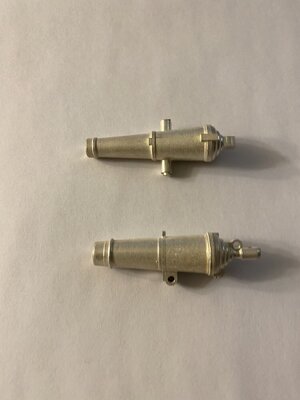

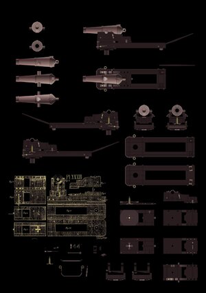

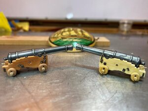

In the meantime, we have finished the construction of the 12 pounders and I attach a couple of photos.
The pear carriage (dark) is for the painted model and the boxwood carriage is for the shipyard one.IMG_20200810_174801.jpgCanons de XII d.jpg
Any comment will be appreciated.

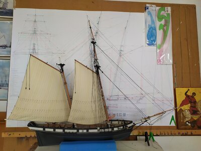

Hallo @Denis Gaille ,
How is the work on your Terpsichore? It would be very interesting to see an update of your amazing model

She is looking very good - and very realistic sails.
Please show us more of the model - and maybe you can also explain, how you made the sails !!
Dec 28, 2018
25
78
For the sail making, I will ask George (he is the master of it!!) to give me the whole process...
Beware!!! It is not simple... nor easy and time consuming. One thing I know is that the material is of utmost importance.
Sewing and forming (to give the impression under wind) is another story!!!!
I will come back to you on the subject.
This would be very good to know and get explained, how George made them - good made sails are (in my opinion) very important for a good overall appearance of a model - I am looking forward ......
