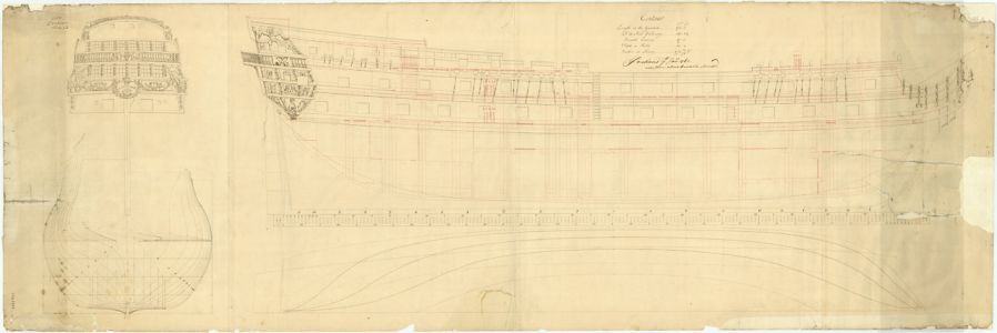

It sounds like you are new to ship modeling. Building a fine wooden 74 gun ship will require somewhere near a thousand hours of work or more for an experienced ship modeler, more if you are rigging it. This is not a minimal endeavor. Forewarned is forearmed. There is a small scale plastic kit of Le Superbe 1784 from Heller and a wooden kit from Mantua but she was part of the Téméraire-class of 74s so there will be differences, including a copper covered bottom.
The information I have seen that is closest to Magnifique 1749 is a set of contemporary plans of Centaure (74) 1757, a ship that the British captured in August of 1759. The RN was pretty diligent about making full sets of plans for captured vessels such as Centaure. These are all available at the Royal Museum Collections site in low resolution for free or you can purchase high resolution plans from them. https://www.rmg.co.uk/collections/objects/search/Centaur 1757 One of her plans can be seen below. Again, if you are a novice, this probably is not a good way to start in the hobby.

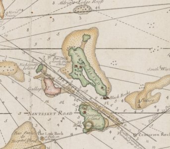

Brett Musee contacted gave photo log and chart found in State Digital collection Boston Massachusetts
