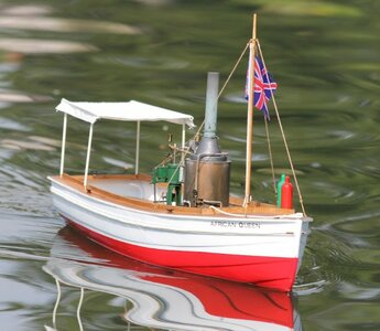

The African Queen - With Live Steam - Billings - 1:12 - by Wayne

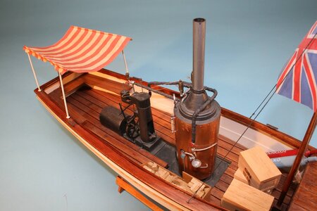

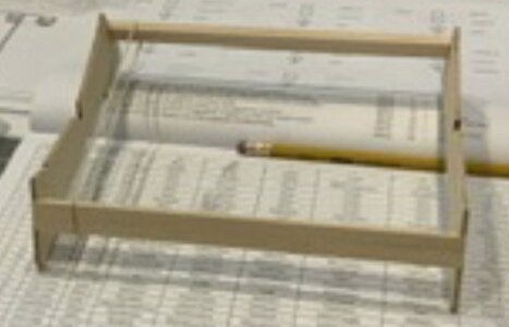

And I must say I love my cut off tool I bought a couple of weeks ago.
A wooden kit you assemble, but I changed the kit blade to a UK Stanley one, it is much sharper.
And for the crates, you set the stop and then cut the strip wood to all exactly the same length that you want.
And the precise cutting is very very fast.

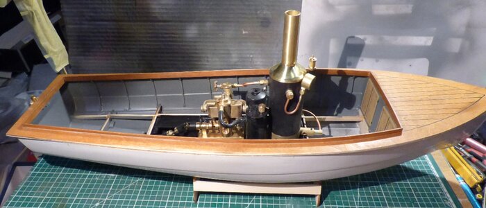

You did wonderful job on your planking
and the creates looking excellent.
Well done Thumbsup

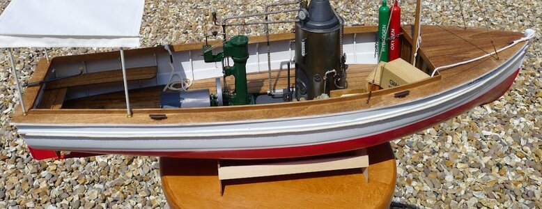

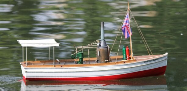

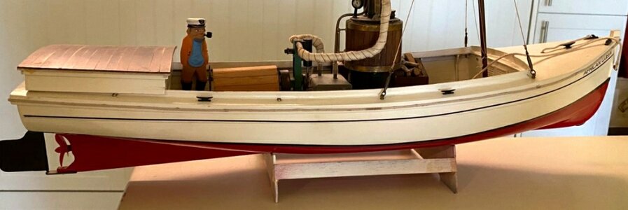

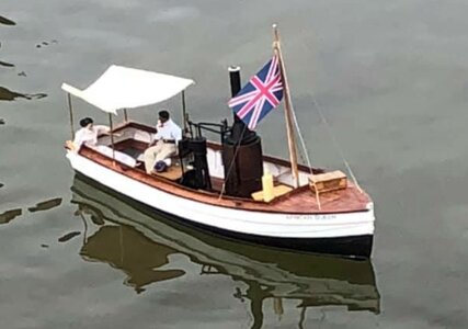

Hi Guys, back again, this time with my rendition of Charlie and Rose.
They are not exactly as the film, but about the best I could do.
And yes it’s been a long journey, finding suitable seated 1:12 scale figures, ordering and waiting for delivery, then re modeling them with my Jewelers saw and Dremell tools, and then re painting them. And making hats etc.
Mods on Charles ……….
Re did his shirt, shortened his jacket, put a bottle of Gin in his right hand, raised and rotated his left arm / hand to hold the tiller, turned shoes to boots etc and have him a peaked cap.
Mods to Rose ………..
Removed her watch and glasses, raised her tops neckline, rotated her right arm / hand to hold a coffee cup, moved her left arm / hand down onto her leg.
And some re painting and made her a big sun hat.

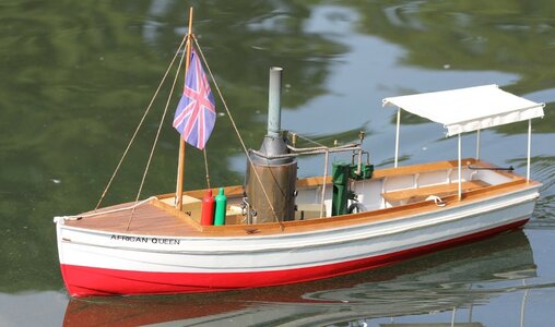

Hi Guys, a little update on my African Queen.
Finished all the RC electronics.
I’ve had this basic Fly Sky 6 Ch radio here for some time now, so good to put it to some use.
Model FS-CT6B
But I’ll only be using 2 channels, for steering and an electronic Sound Module.
I have decided not to have any control on the Steam Engine, so no Go / Stop or Forward / Reverse.
But I guess that could be added at some later stage.
The sound module runs on 6–12 volts, with better performance on 12v.
So I have installed a 11.1 Volt LiPo battery, which directly powers the sound.
I have installed a 6 volt Voltage Regulator / BEC, to power the Receiver and so the Steering Servo.
So there won’t be much drain on the 450mAh battery, especially when everything is at idle.
With the servo I’m using, I found I needed more rudder movement, so I added an in line adjustable Servo Tuner.

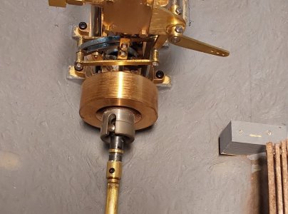

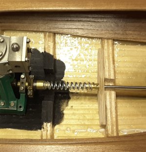

I hope you're still active on these forums because I wanted to pick your brain about the brass propeller diameter you went with and the propeller shaft, since Float a Boat have many options. Which item numbers did you end up buying that worked with our boat?
Also, would you be able to share some pictures of how the steam plant connects to the shaft/propeller? I'm guessing I'll need a couple u joints/couplers, but I'm unsure and trying to visualise it in my head before starting the build.

You've given me lots to think about. When I'm down at Bunnings Warehouse (a popular hardware store here Down Under) one of these days, I'll be sure to keep an eye out for adequate springs and rubber tubes. It would be nice to keep propeller shaft chatter to a minimum.
Wayne, please when you get a chance I'd still love to know what prop diameter you went with. When I measure the Billing Boats prop that came with the kit, it measures roughly 22mm in radius, so I assume a 45mm prop is the way to go but I want to be certain before pulling the trigger.
Edit: looking more closely at the parts list that's included in the instructions I see that it's a 40mm prop. Just closing this loop in case others wonder the same. :)

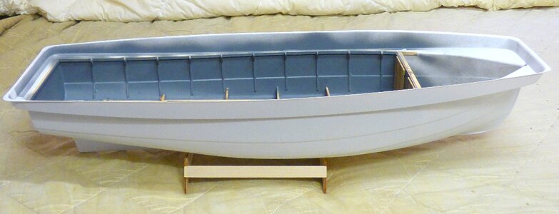

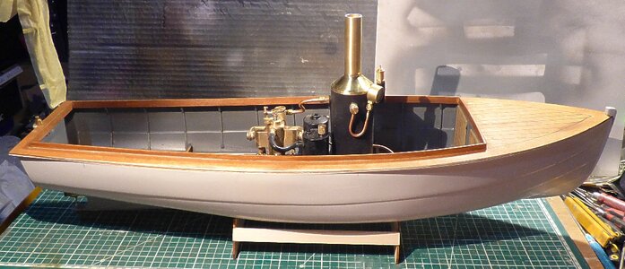

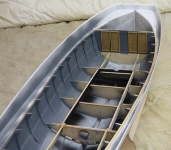

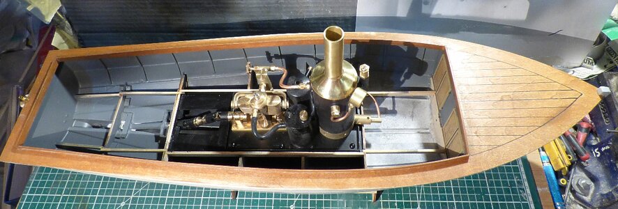

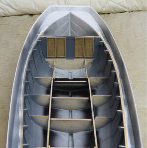

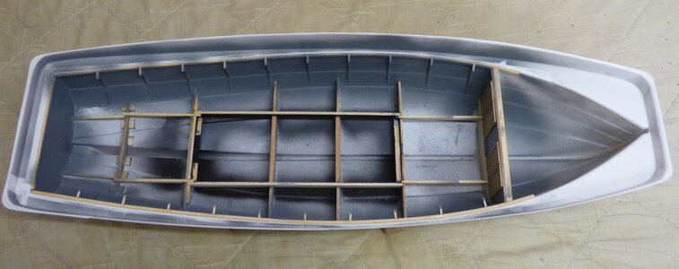

This has been a quest of mine all my life, I saw the movie as a very young boy when my parents went to the Drive In Pictures, around 1953. And I have always remembered different scenes from the movie. So I have now finally got around to building it, and with live steam. And intend to have RC for the steering, I will just let the steam engine chug along. Yea being an open launch I don’t want to have servos etc spoiling the look of the model. I hope to hide a small servo for steering under the rear seat.

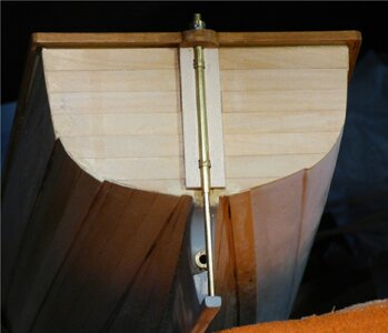

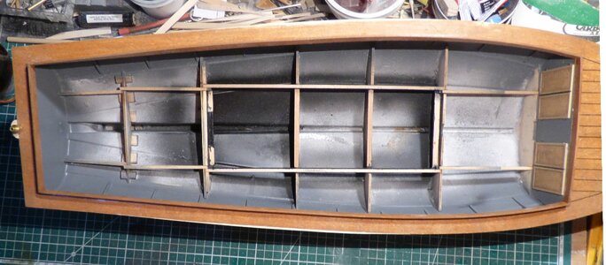

And the vacuum formed plastic hull will be water tight when on the water. But I’m thinking of planking over the hull, I hope that will be OK.
And I must say, the most important tip I picked up while researching the build was to leave the top extra mounding there, not cut it off until the hull internals and deck were completed.

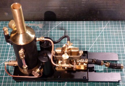

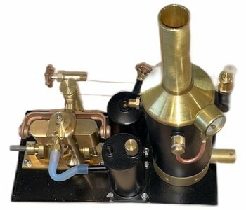

I have the ‘Miniature Steam Models’ plant #4034 here to go into the boat. I must thank gjdale, (Grant) for guiding me to that plant, and it looks spot on for the Queen.

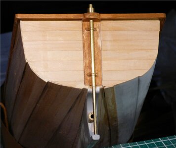

Just ordered 2 universals, 5 to 4mm, and a brass prop from ‘Float a Boat’, also in Melbourne, and they were very helpful. Will have to see if I use the Billings prop shaft or have to buy a longer one.
what adhesive did you use glueing wood to plastic? I attempted one build with a plastic hull and had trouble. your african queen is great
