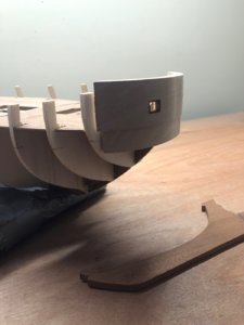

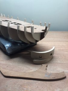

I think you need to carve down the bow blocks to profile the stem of the model. Then the planking is veneered over the top of the blocks.
I'm having a problem with the bow, I'd like to know how to put those two pieces correctly and how to arrange wooden stripes correctly in order to get a very nice bow. Thank you in advance!
