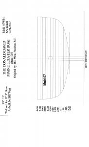

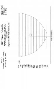

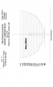

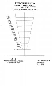

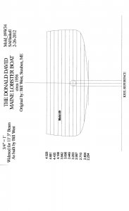

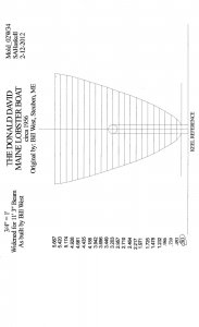

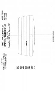

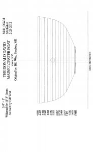

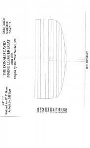

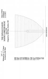

This is me, between William & his grandson, holding the half-hull model he used for all three of the boats he built. He gave me the half-hull about 25 years ago. I have measured, re-measured & measured again create 10 molds for my model. The Half-hull is 34 inches long and is 1” = 1’ for the Donald David, a 34 foot long boat; bigger & faster than his previous builds. My model will be at 1/16” = 1’, so the model will be 25.5” long.
I purchased a book, “Boatbuilding Down East,” sub-titled “How to Build a Wooden Boat,” by Royal Lowell, from Topsham, ME. The book is a tremendous treasure trove of boat building info covering everything from stem to stern. It includes several drawings of boats he has made, with some lines drawings.
I also bought a two-page blueprint, #17, from the Maine Maritime Museum. This plan is for a 34 foot lobster boat built in 1964.
Since a half-hull model and my memory are all the info I have about the Donald David, I need all the help I can get.
The following mold drawings are greatly reduced to conserve space, but I can provide full size copies.
(Remark Uwe: I could not copy these drawings into the post - so please take a look at the attachment from Steven in original post)

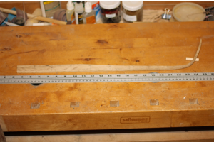

I have all the molds cut in 1/8” plywood, waiting for me to re-make the keel so I can attach the molds. Here is my 1st attempt at the keel. which turned out to have not enough height for the model. I’ll be more careful next go around.

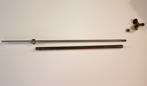

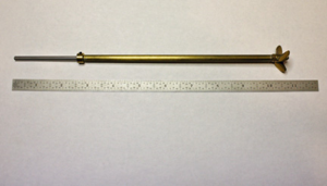

Here it the propeller Shaft that I made from brass tubing and threaded rod.
97587
97588

The files that you could not copy are CAD drawings that I copies and pasted into my Word Doc. ! will scan my drawings and save them as jpeg files. Sorry for the inconvenience.

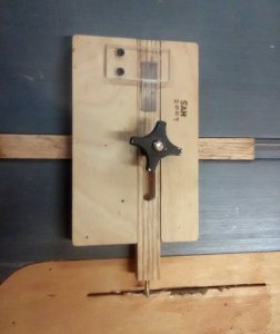

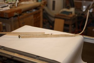

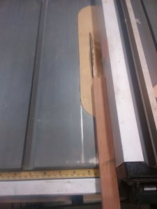

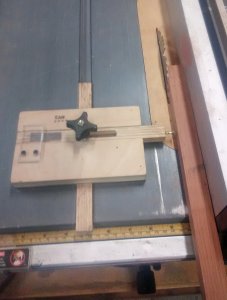

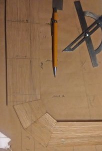

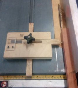

I have made a little progress on the keel replacement, cut & glued white oak strips and sanded them to 3/8" thick. Then I cut away a few shorter pieces with angled sides (11 degrees & 22 degrees) so I could cut tongue & groove joints on the angled edges to create a turn in the stock that will become the stem. Here are a few photos that should clarify. I am now working on transferring the keel/stem pattern to the assembly.

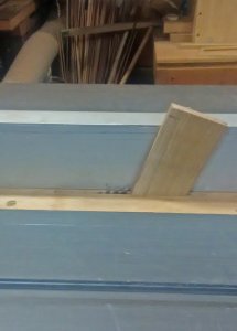

While I was at the saw I got the urge to cut the cedar stock for planking. That went very well, using my table saw with a jig I made several years ago. I cut 50 strips, which is considerably more than I need (I hate to run out during assembly). I used a 7" saw blade from my portable, circular saw; it is only 1/16" thick and cuts very smooth! It is labeled as a "Planer Blade" for the portable circular saw.

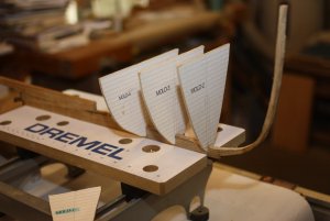

FINALLY, I have the shaft tube glued into the two parts of the keel. Still have to finish shaping the keel. Just for fun I placed Molds 2, 3 & 4 onto the keel an took a picture. The molds are only temporary and will be removed after the frames & planking are done. I apologize for my slow progress. Keep in mind that it took me many years to get to the point of cutting some wood.
