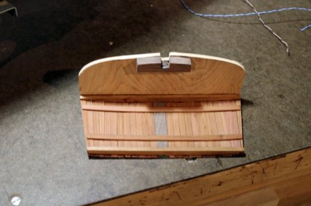

Finally; I have assembled the aft deck of the Donald David. It will be installed with pins/clips that that will allow removing in order to install/maintain the rudder. The surface of the aft deck will be painted white, as it & the hull were on the real Donald David.
Happy Modeling
Steven

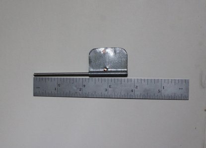

And---- I switch again! The rudders that I saw in the catalog won't fit under the rear deck, The rear deck is lower than on most boats.
Since I had some scraps of stainless steel, I got creative and came up with this. I will round the rear edge some more. I'm hoping it will work well.
Happy modeling,
Steven
Wow. Stainless is not easy to work with, but you’ve produced a fine-looking rudder.
