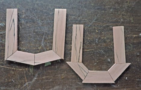

Harold Hahn did not fabricate his frames realistically with floors, futtocks, scarf joints and chocks. He took a simpler, more artistic approach using 'butt-joints' to create his frames, as shown below. This image comes from Dave, himself. Once glued, these two separate frames would be glued together forming 'sistered' frames. When cut and sanded to the final shape, these two 'sistered' frames would appear as though they were made via futtocks, as seen from the outside of the ship models. I hope this makes sense. I'm not sure that I explained it very well.

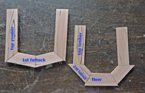

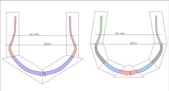

actually the frame blank are floors and futtocks just not shaped to the final frame. Just about all the ships built in North America and including French ships futtocks were butt jointed Chocks were not used.
all the Hahn framing used futtocks which include any of a number of timbers forming the lower, more curved portion of the frame in a wooden hull.
in the Fredrick frame 12 is made up of a floor pink part, futtocks 1 and 2 and the top timber. The sistered part is made up of a lower futtock and the top timber.

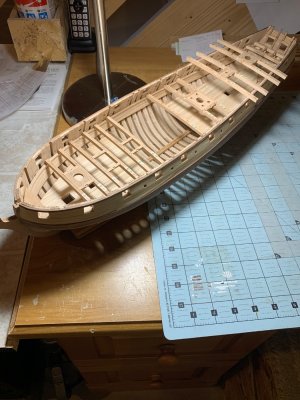

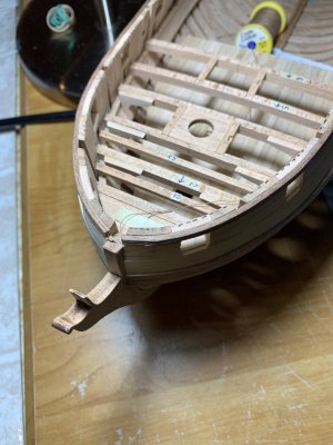

Slowly adding deck members at stern. Once the deck , ledger , mast partner unit is in place I fashion the hanging knees and attach them.
