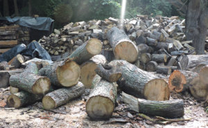

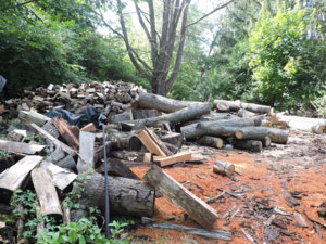

last few days more logs came in and that red color in the fore ground is not from something i killed i am cutting Cherry logs and using an industrial professional grade chain saw.
wood this size requires strong tools those logs don't look that big until you stand next to them and realize some are 28 inch diameter
