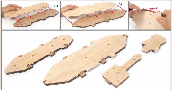

Here you see the false deck parts, they are almost 3.00mm (2.7mm exactly)

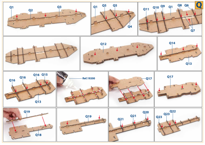

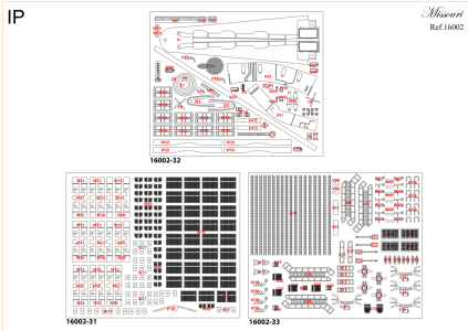

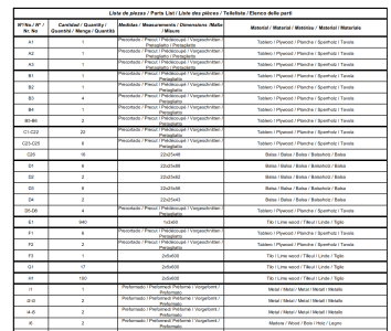

This is all the wood supplied in the kit. What can I say? The MDF becomes a standard for keel-structured parts as it doesn't warp, and is not affected by temperature changes. The plywood is high quality and doesn't show splintering across all the boards. The actual planks seem to be Limewood. They are nicely milled with precision and uniform in color. The smaller width planks might be required as an additional purchase or your stock, if you decide to go this route. Almost forgot, the boards don't have identification numbers. However, all parts can be identified from the instructions, they are labeled 'IP' (Identification Part). Here is an example of one of the sheets.

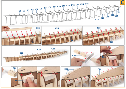

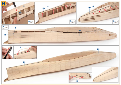

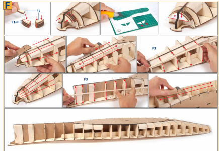

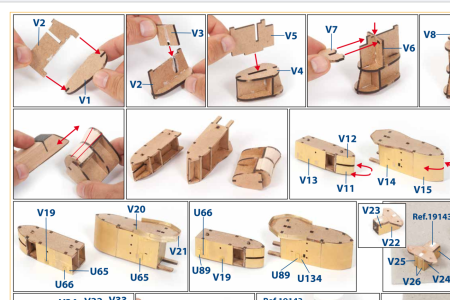

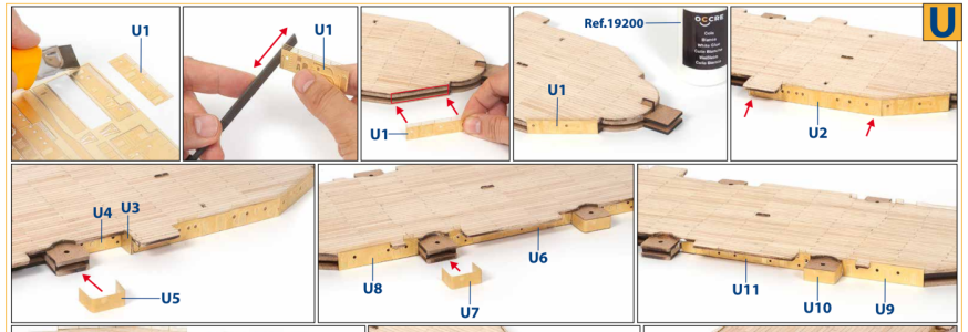

BTW, going a bit ahead of this review, all assembly stages are labeled alphabetically so are the parts required for this stage. For example; The IP sheet below identified some parts required for stage C as they all started with the letter C. Combining this identification sheet with the instruction manual step-by-step (below the IP sheet)... it is all clear the bulkheads C1, C2, and so on... are for the frames assembly. is that easy
