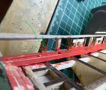

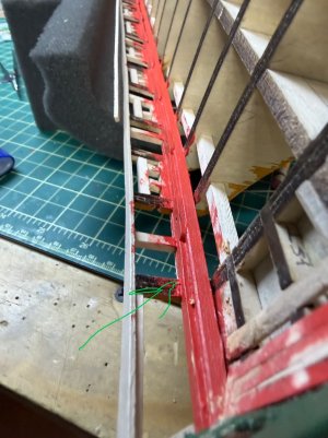

Planking the transom and ceiling are my nemesis du jour. but it started with figuring out the stern blocks (I’m 3D challenged). The ceiling planks aren’t going to be square without some serious sanding. I’ll have to take down half of the bulkhead down for the planks to fit properly.

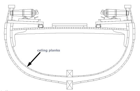

to begin there are no ceiling planks on a bulkhead hull these are ceiling planks from the deck clamp to the keelson
what your showing is the inside of the bulwarks

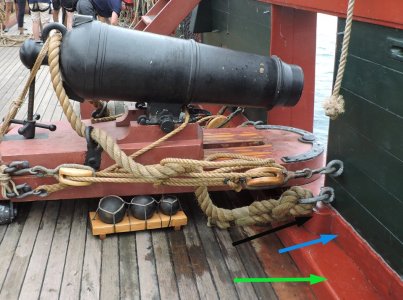

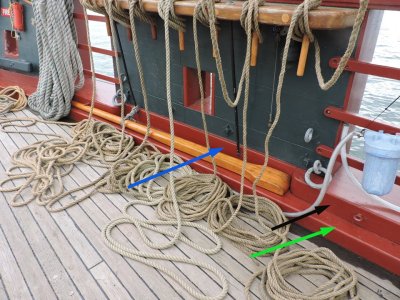

taking a look at the Niagara the green arrow is the waterway the black arrow is the gun port sill and the blue is the lower bulwark molding

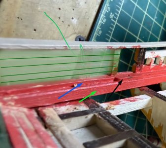

on your model everything looks good and all you have to add is the inside of the bulwark planking
with the carronade in place you can see each piece
From your photo (once you turn it 90 degrees to the right) are you referring to the planking on the inside of the bulwarks? I’m not a sailing warship expert but I believe that this is called Spirketing (sp?).
Anyhow, the insides of the extensions of the bulwarks need to be faired just like the parts of them that support planking on the outside of the hull. You may have to add some slivers of wood to help them line up.

New vocabulary unlocked. Yes those planks.
