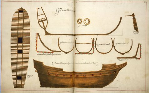

Fernandes' drawings, although visually impressive on the one hand, are not the epitome of precision and are primarily illustrative in nature, apparently to facilitate and encourage a favourable assessment by a decision-making body. However, they did not need to be dimensionally accurate, since this particular design method, due to its relative procedural simplicity, did not actually require the prior preparation of reduced-scale plans on paper, and the actual construction could be started immediately on a real scale, while the written dimensional specifications prepared in advance could be completely sufficient to commence the work.
Examining this case was by no means an easy task of just following a given recipe, as Fernandes basically limited himself to providing the dimensions of various components of the structure. Ultimately, however, this specific investigation allowed for the discovery of further, previously unknown details or design subtleties proper for this design method.

Drawing of the design in question on page 104 from the Livro de Traças de Carpintaria:

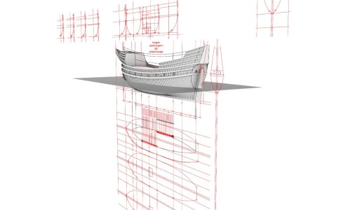

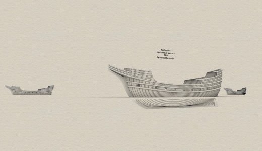

Reconstruction graphics:
Those would make beautiful framed prints
Thanks :). Despite their specific nature, such graphics in themselves may indeed appeal to some and be an unusual or quite surprising decoration. Although I admit that my original goal was mainly to demonstrate, that direct use of contemporary sources is possible and can be quite useful, including issues related to the lines or general shapes of ship hulls.
