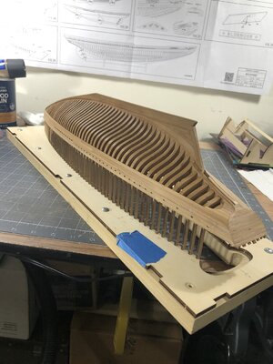

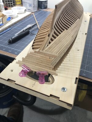

A little bit of progress and a possibly a better mouse trap. I began placing the hull planking and decided that leaving the jig frame in place provides the best stable platform for this operation. Once completed I will remove it. I use my trusty plank bender (womans hair curler) which works really well. Just dip the end in water a minute or two then heat and bend.

I tried several methods to hold some of the more argumentative planks fast to the frames and came up with this. It works great! Take a simple paperclip bend it as shown, insert between the ribs and turn it 90 deg then wedge it in place.
