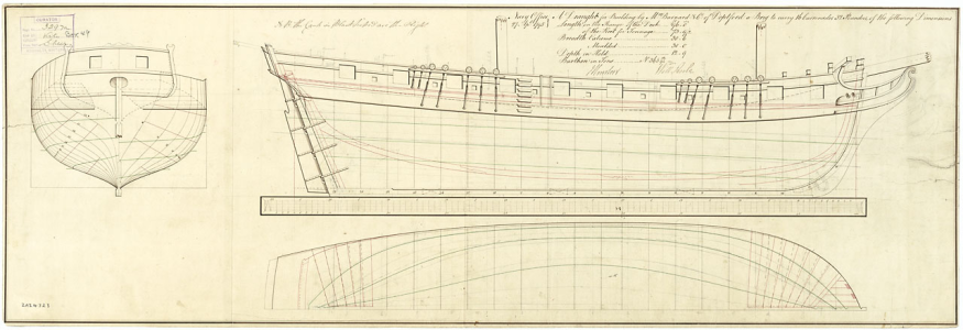

over head deckplan doesnt, but side plan shows a very abrust raised section

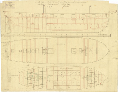

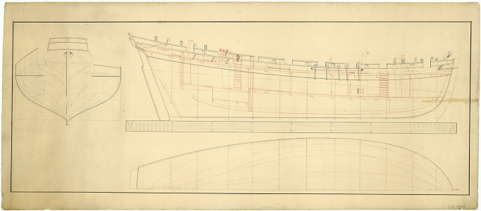

This is quite interesting and maybe a bit unusual. I just looked at a number additional plans, including deck and profile plans. The first not dated and has no stern ports. The next has stern ports but neither have raised platform that I can see. Ther third is similar but no raised platforms. The last has what may be housing around the rudder and a platform shown in dashed lines.

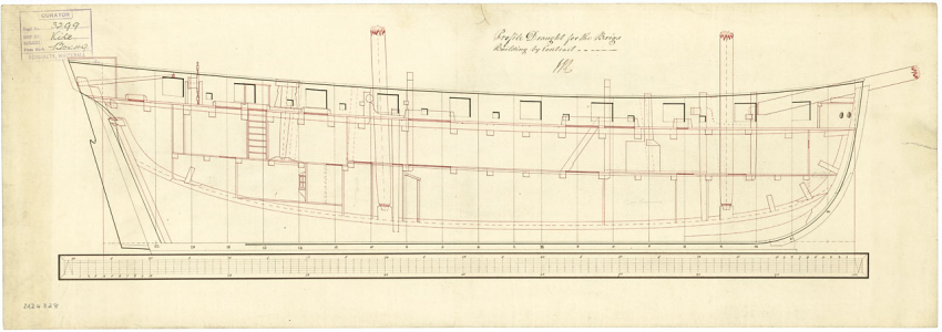

KIte 1795
A third drawing from circa July 1795 for Albatross Dispatch, Kite, Raven Star, Swallow Sylph and Pelican all 1795. There are small deck houses aft, perhaps heads, but no raised platforms.
There was the 1805 version of Kite that is a different design than the earlier Kite and Alert but has what may be the rudder housing and platforms Goodwin mentions on page 14 of the Alert book.
