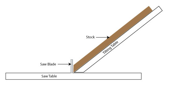

While certainly not as elegant, the tilting table for the Byrnes saw is easily replicated with a shop-made jig. The Byrnes tilting table is simply a "ramp" which raises the table surface to a desired angle to permit an angled cut from the vertical saw blade. Thus, for a cut of any angle, one can simply cut that angle on a larger table saw and clamp that angled "fence" to the top of the stock Byrnes saw and run the workpiece through the saw, using the angled "fence" to produce the beveled edge cut.
