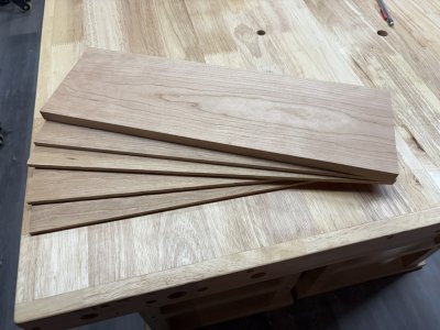

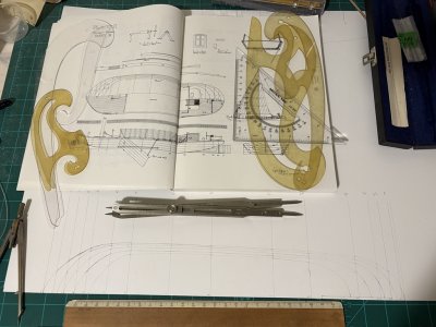

This is a bit of an aside, but talking about Grimwood got me thinking about building a model ala Grimwood. Earlier this summer I made a half-hull model of Carrie Price - the first project in the book. The second and third projects are also related to Carrie Price; a half-hull model with deck furniture and then a full-hull model. I decided to skip to the next subject in the book: Piscataqua Gondalow “Fannie M.” Like the half-hull model, I am going to try to stay somewhat true to the building practice suggested by Grimwood and I am not going to add much if anything in terms of detail that wasn't presented in Grimwood. (I am also looking at plans for the vessel that are in Chapelle's The National Watercraft Collection, but am not going as far as ordering plans from the Historical American Merchant Marines Survey. I'm just trying to be early 1940's here!
Of course I deviated almost immediately and spent $10 on some Cherry wood - Grimwood would probably expected that the builder would use pine. Also I have the tools to mill the lifts - Grimwood says, if you don't have the tools buy your wood from a mill that will make pieces to the thickness you need. I also expect that there were some excellent craftsmen making models that could use hand planes to make exactly what would be required.
While I have the tools to mill the lifts, I am not a CAD person! So when doubling the size of the printed plans some low-tech methods were employed. [Blowing up the plans with a copier may work well - you would just need to be carful piecing copies together because the plans go across two pages and some information is lost in the binding - unless you are lucky enough to have an original copy with fold-out plans.] I made good use of proportional dividers to double some of the dimensions and used French curves / ship curves to develop the lines needed. Here are pictures of the 5 lifts and the drafting outcome.
I will probably update progress periodically here - not exactly a build log, but rather a reminder that scratch building doesn't need to be expensive nor overly complicated.
This is the type of construction that Grimwood uses for all of the models in the book - the projects get more complicated due to hull shapes and rig. Also, this is an example of a vessel that Chapelle thought would be good to model and an idea of the level of detail that was deemed satisfactory - at least for a beginning modeler.
