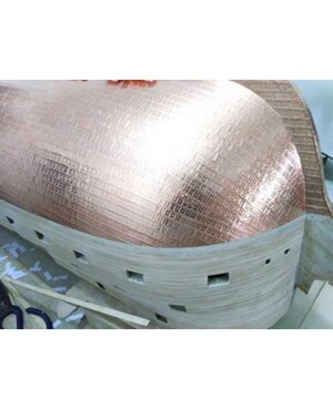

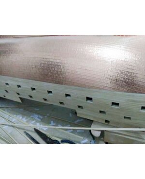

I have used diluted PVA wood glue with great results for sealing the timber under the copper plates.

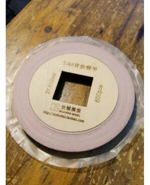

Hello, Ian. I am in no way an expert, but this product is might be what you are looking for. Check this out.
The diluted PVA absorbs into the pores of the wood which sticks everything in place. It leaves a nice smooth matt surface for copper plating using super glue or contact cement.
I would strongly advise you roughen up the inside surface of the copper plate before you stick them down Ian. I use 120 grit sandpaper.

Bryian, what type of copper plates are you using? I was contemplating using copper tape but that would rely on the adhesive on the tape to hold down the plates. It sounds like you are using something different. Can you post a reference site for them please?
Hi Ian,
I'm only familiar with the copper plates that are sold by modellers shipyard in N.S.W. They are individual plates that need glueing into position.
