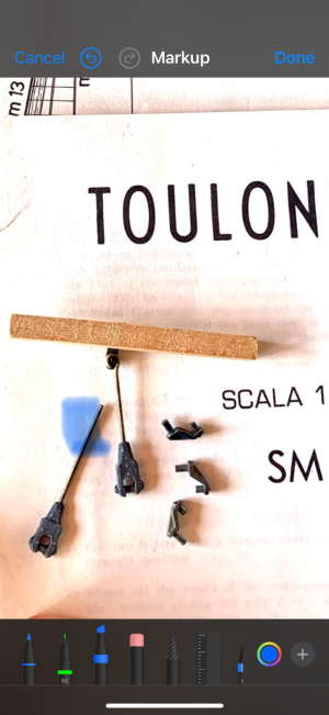

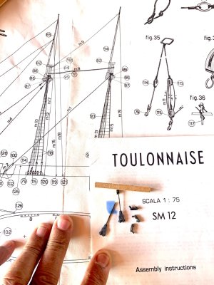

Hi Dear Members

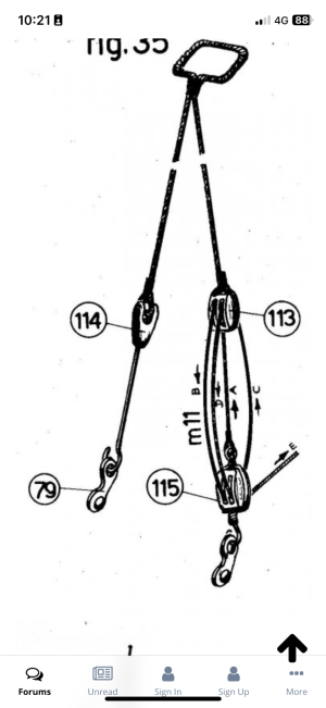

I have no idea how to adjust the tension of the masts (for standing rigg) using the objects given by the kit According to the plans given by Corel.According to fig 35 only one of the length of the of shroud lines can be adjusted and it does not make a sense for me.Normally using turnbuckles or deadeyes the tension of shroud lines can be adjusted seperately
The original plans and objects from the kit are in the attachment
Thanks in advance for your help
This may help you:
As I understand it, the tackle was used to set the mast straight, giving the shrouds enough slack to be mounted with these rods of fixed length. After this, the tackles could be used for any kind of lifting, so were left in place.
