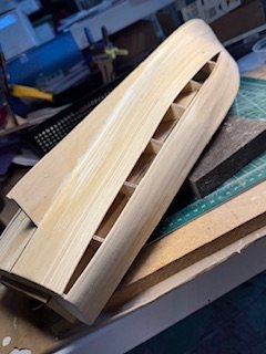

This concerns basic planking technique for POB kits with supplied planks. I am a beginner ship model maker.
I understand the basic technique of working out how much to trim off each plank along the bulkheads. Working through that now on my Mamoli Catalina kit.
However, I have two references for basic planking. One says ALWAYS trim off from the top of the plank; one says ALWAYS from the bottom.
Is one of these references wrong, or maybe it does not matter as long as you try to do it consistently.
I realize planking method is a large and complex part of the hobby with many approaches, but here I am just getting started and already getting two opposite directions.
Thanks for any advice.

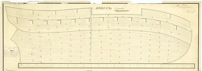

3. There is a picture of a planking layout in this thread that gives you a pretty good idea of what the planks are going to look like depending upon their position on the hull. GOOD TO STUDY THIS PICTURE.
The accepted method is trim the bottom edge so you have a reguler even top edge to facilitate fitting the next plank.

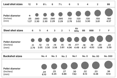

The size of the pellet depends on both the scale and cannon size. A 32 pounder cannonball for example is about 6.1" At 1:64 scale this would be number 7 1/2 shot. A BB gun might be the ticket but likely too large diameter (0.177 - 4.5mm) It will penetrate about 1/16" (1.6mm)
If the scale of the model is 1:72 such as the Caldercraft Victory, #9 shot would be about right but how to fire them? Maybe make your own small cannon with the right size diameter. We made little cannons with pieces of scrap iron and brass rods as kids and the ball would penetrate a tin can. Talk about shooting your eye out kid.
