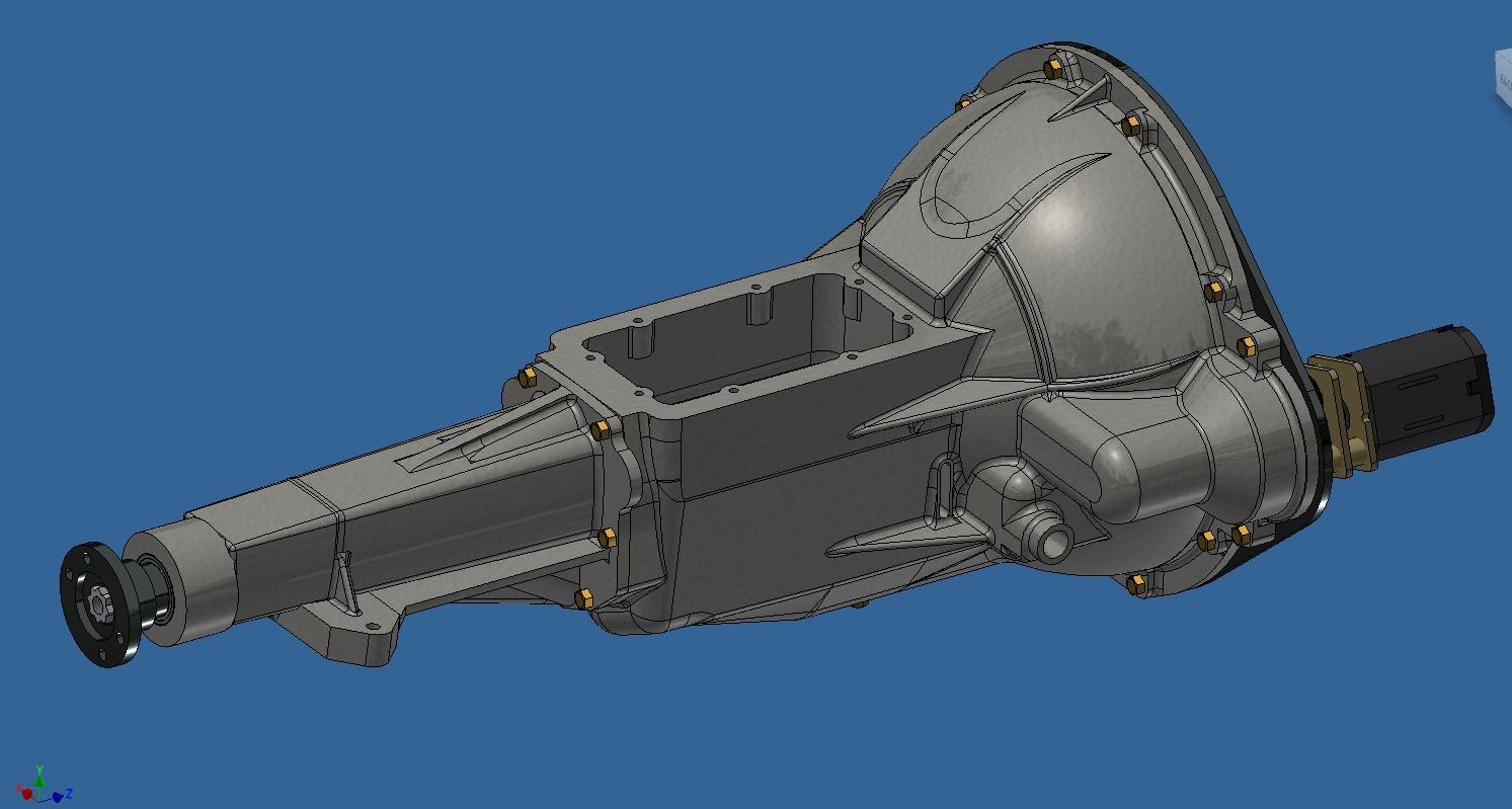

With the differential done, I'm slowly progressing back towards the front of the car. I did the rear brakes and started the transmission housing. It's composed of 3 parts. The tail housing, the bell housing and the shifter housing. Having restored this car for real, l have a ton of literature. One of these books (the tr6 maintenance book) is full of really nice hand made 3d drawings (remember that it dates back to the pre-computer era) and some just as nice cross section views. There's one of the transmission that I used to 3d model it. Combined with pictures from the net and measurements from my car, I was able to do a decent job of it. It's not finished but not to far either. I still have the complete shifter housing to do. On the hydra, I made a mecanism activated by the shifter to engage the rear wheels but it didn't work well. For this one, I would like to make the actual friction clutch and engage it using the shifter instead of the clutch pedal.

3d model of transmission so far

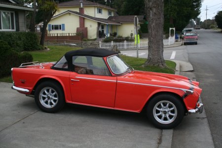

Below is a picture of the TR 6 prediceser. The American import called the TR 250 built only one year in 1968..
Wow, the 250 was the nicest of all TR'S.

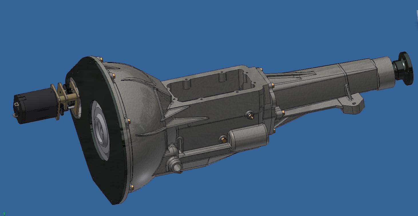

For those of you who work with computers, you know that eventually something will go wrong. Well something did go wrong will my bell housing 3d model. After close to 8hrs of work, the file decided to become corrupt and could not be opened anymore. It's a very complex part to do so redoing it wasn't all that fun. The good side of this is that it went faster the second time around and that I'm more pleased with the result.
Bell housing V2. You will notice that the gearmotor has been placed where the starter motor normally is. Being a 1/6 scale model, I should have enough space inside the starter housing to hide the gearmotor.

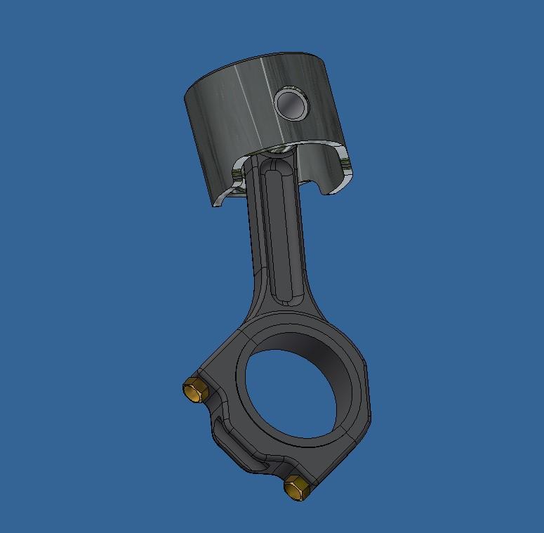

I also started work on the engine, I did the pistons.

On the Tr6 front, I finished modeling the transmission, the clutch and the shifter that will actuate the clutch. I also finished the starter motor with the gearmotor hidden inside.

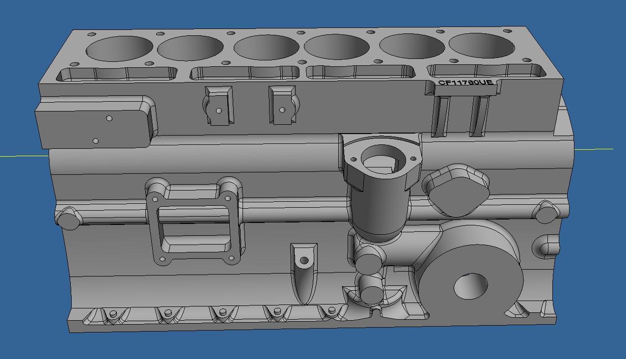

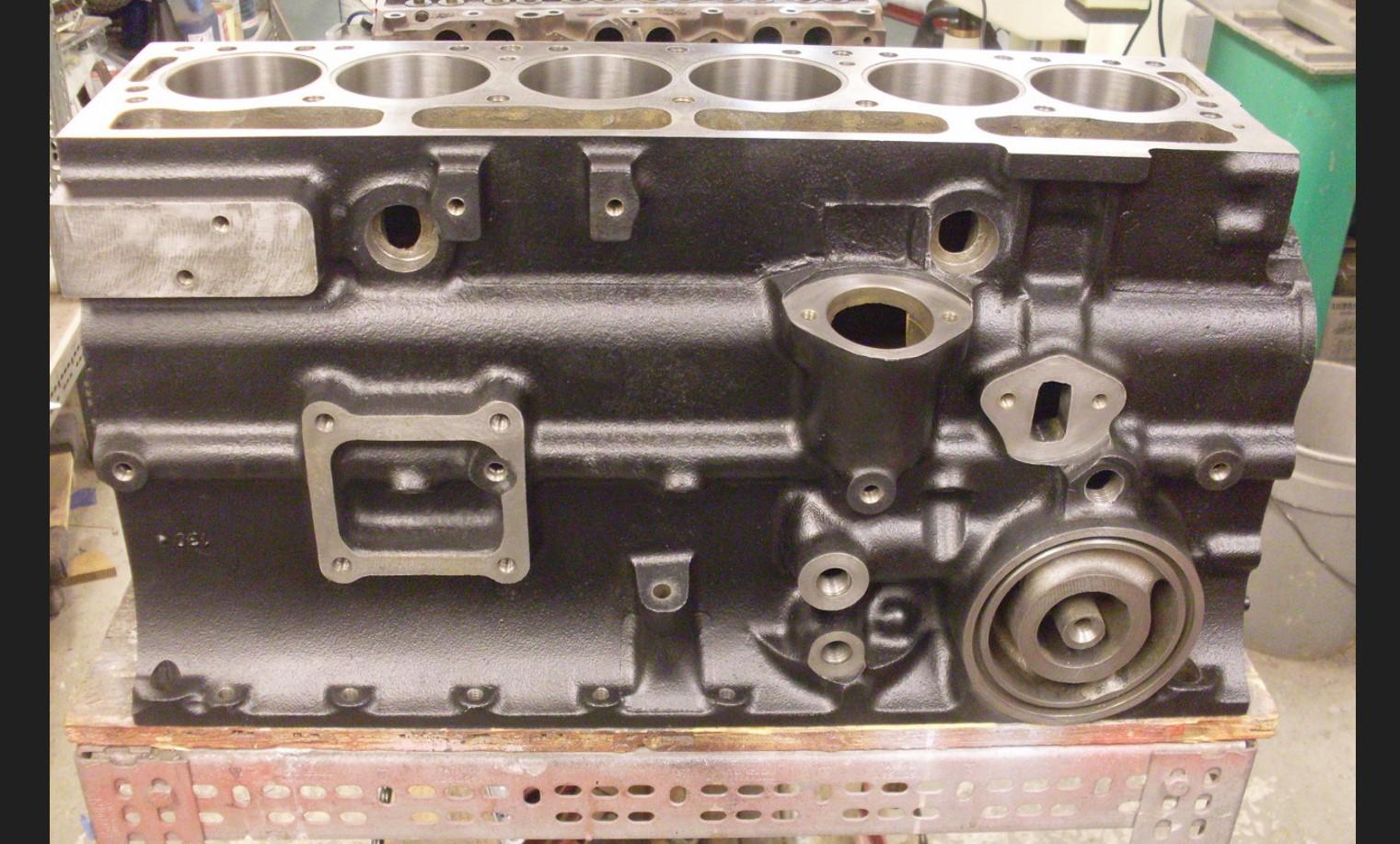

Then I started the real meat, the engine bloc. It's about 95% done and 95% accurate. Like any engine bloc, it's a pretty complex part with lots of features. I took a few libertys such as adding ball bearings at the front and rear of the crankshaft. Aside from another Tr6 nerd like me, I don't think anyone will see the 5% innacuracy. I'll slowly model all the add-on parts but there are a bunch so might take a while. I would like to have a rotating ignition rotor in the distributer just for the fun of it. I'll see if it's possible but since the distributer takes it's power from the camshaft and I plan on having a rotating camshaft, it should be doable.

Starter motor
With hidden gearmotor
Almost completed bloc
Vs a real one

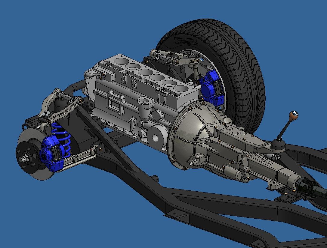

And on the frame

Starter motor
Vs a real one
And on the frame

Not being critical here, but what are the two missing bosses on the cylinder head for, freeze plugs?
Today, I modeled a few more parts. The motor mounting brackets, the alternator mounting bracket and the distributer mounting bracket. I also completed the freeze plugs. But the main thing I modeled is the camshaft. I'm pretty sure I got the timing of the cam lobes right but I'll double check. It's very amazing what you can get from Google AI! A few good questions and I had all the info I needed. 110 deg between intake and exhaust cam lobes, a .24 inch lifter rise (.04 inch at scale) and 120 deg between each pair of lobes and in what order to position them which is basically the firing order. Once the camshaft was done, it was a breeze to but in the lifters and pushrods. On the real TR6, the camshaft is driven via a timing chain at a ration of 2:1; 2 rotations of the crankshaft for 1 rotation of the camshaft. After a simple calculation (360deg of camshaft rotation/6 cylinder x by 2 ) you get 120deg between each pair of cam lobes. So didn't really need Google for that one. Now, finding a fonctional timing chain at 1/6 scale is kinda hard to do so instead of a chain, I'll be using spur gears. A 24 tooth on the crankshaft, a 48 tooth on the camshaft plus an idler gear linking the 2 to have the both shafts rotating in the same direction. I then finished of the day by modeling the camshaft drive cover. You would think that with all this, I would't have time for anything else but I went paint shopping, took a long walk and made a killer pasta sauce. All in a days work!!
Freeze plugs and brackets
More freeze plugs
