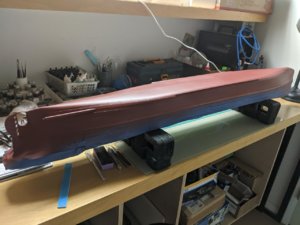

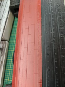

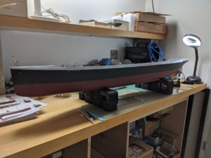

Hull painted the bottom section anti-fowling... used Tamiya Fine Surface primer in Oxide Red and then Tamiya Dull Red TS33 which is what I use for all anti-fowling on all my ship builds so far it is the closest match I can find in a spray can. I cannot imagine or entertain the notion to hand airbrush a model of that scale!hull4.jpg

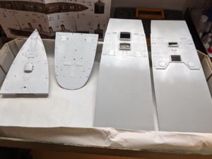

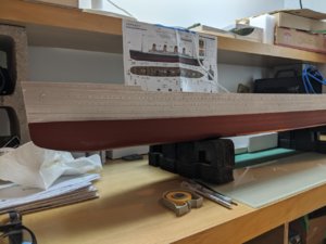

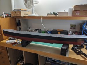

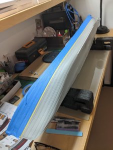

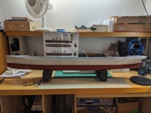

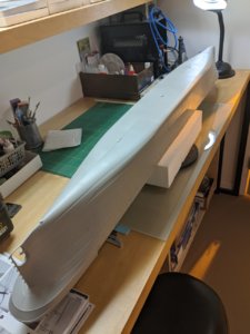

Second round with the hull finishing... realigned the anti-fowling line but still not positive on its location. Followed as best the paint guide and other images on the net.
Applied white primer on the top section to be covered in the middle with flat black next and a yellow pinstripe down the side next.hull5.jpghull6.jpghull7.jpghull8.jpg

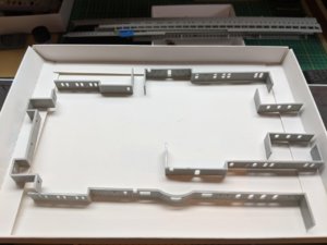

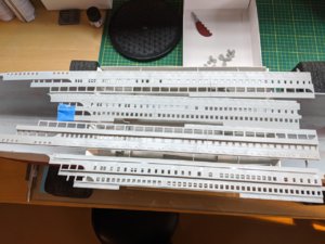

Superstructure side pieces... lots of work to be done drilling portholes and PE window frames... not certain what will use to imitate the glass yet.

Thanks for the suggestions... the kit does come with LED lighting but only for the 1st deck upwards... not the lower decks below. It has been suggested to add supplemental light in the hull but also to paint the inside white instead of black to make it illuminate more?

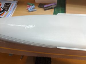

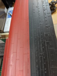

ok so little more work on the hull finish but I had a feeling the boot topping line was off slightly and I was correct if you will notice in the 2 close up image those are NOT portholes.. Doh... they are guidelines!!! Not certain if supposed to fill them up after masking that line off?
