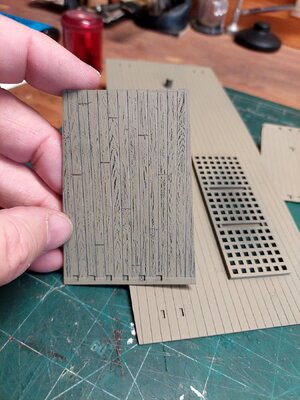

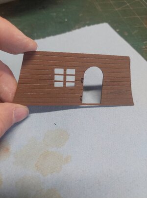

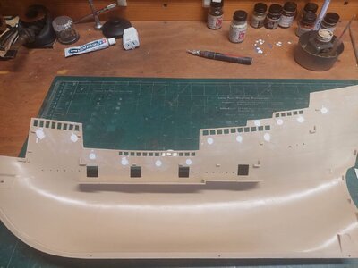

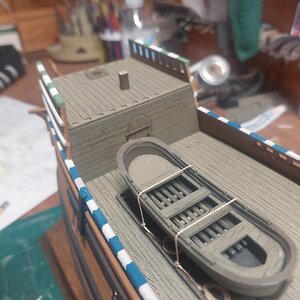

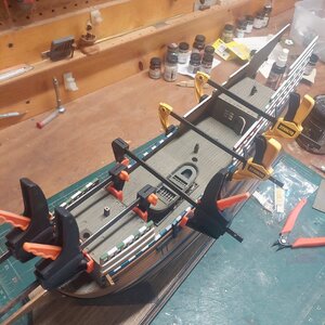

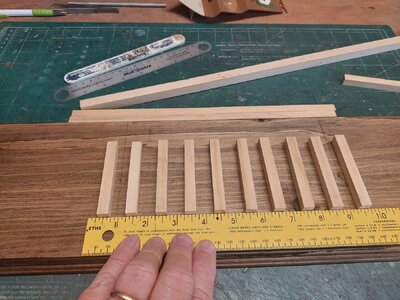

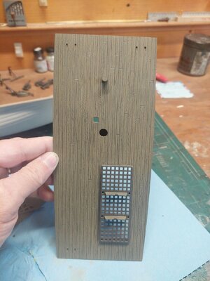

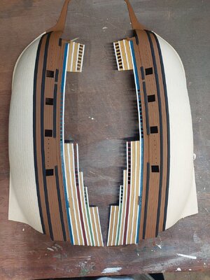

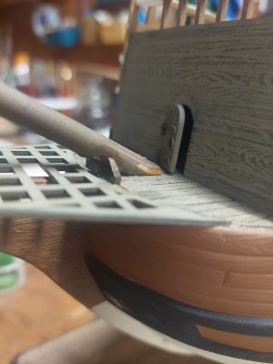

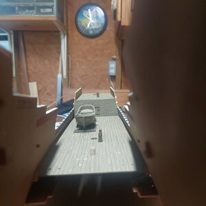

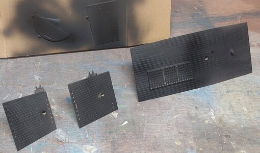

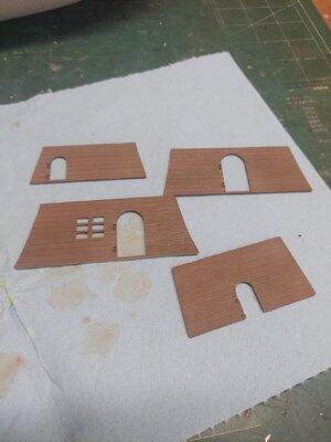

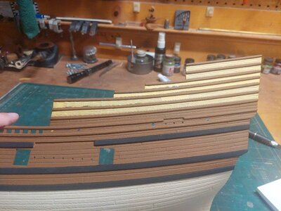

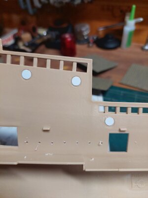

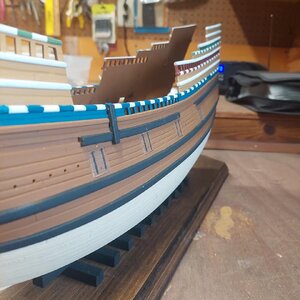

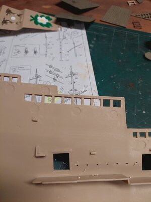

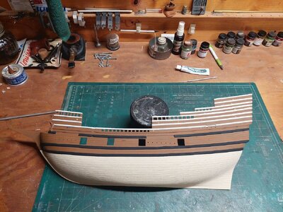

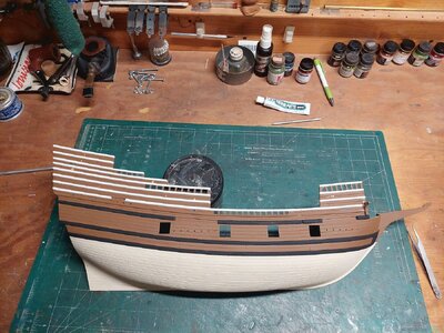

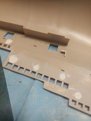

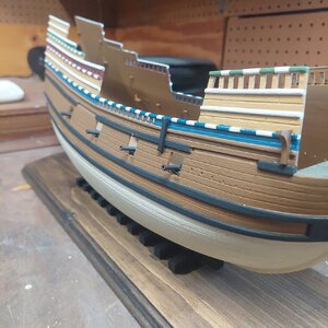

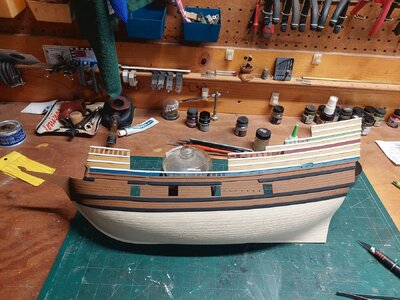

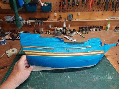

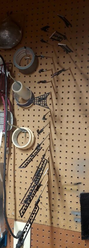

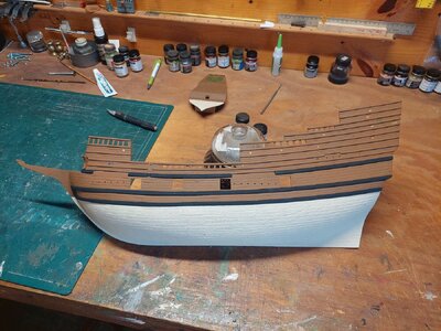

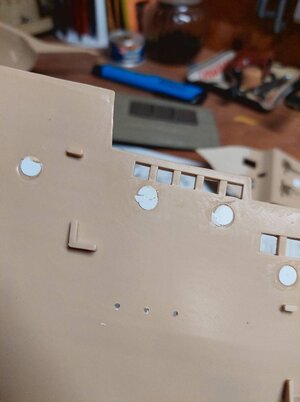

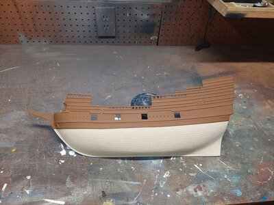

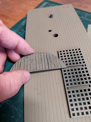

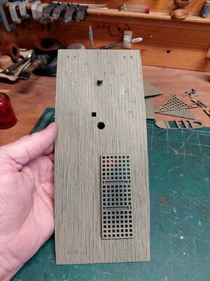

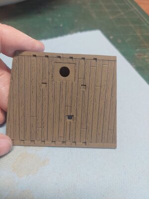

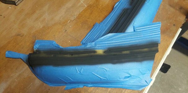

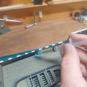

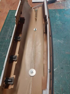

This build in going to be about 10-15% modification on the current kit, the while the model is correct in the general shape, the stern decorations are just (goofy), the bow/jib area has to be modified. while you can only do so much, I want to at least try to correct some of the mistakes. Bill97 on another forum built one just beautifully, which I'm using as my guide. The biggest handicap is the lack of any historical artist renditions (late 1760's paint not withstanding), or decent write up. The rigging instructions and other tidbits are lacking as well. I'll try to make post with each sub-assembly including this post is the model prep. When doing wooden models (in plastic), I like to blacken the base part, then topcoat with a light shade of tan, then lightly rub off the tan to bring out the grain detail. The factory punch marks were all over, so I used a hole puncher to make some round plastic fillers so I would have so much filler to sand.

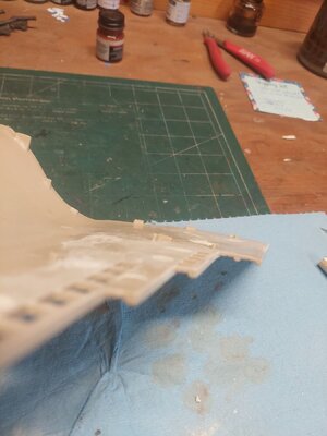

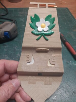

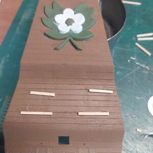

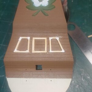

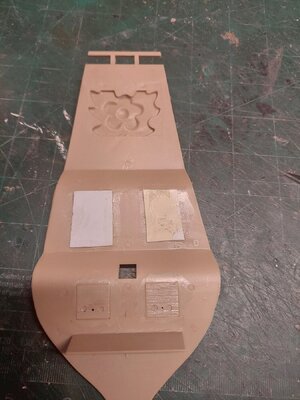

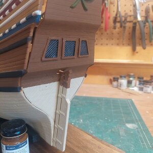

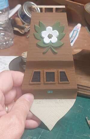

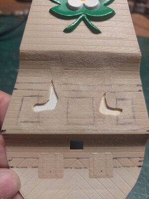

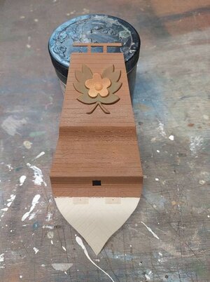

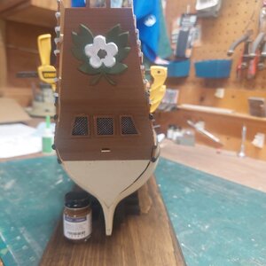

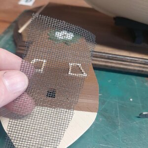

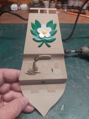

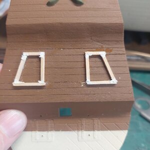

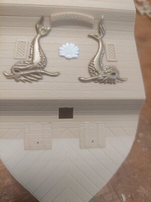

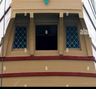

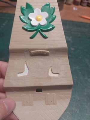

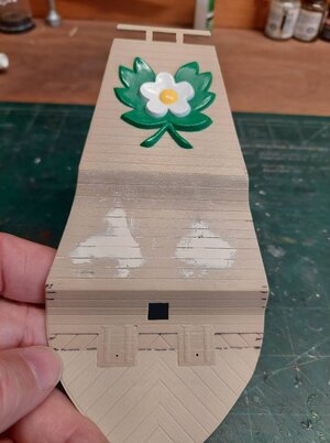

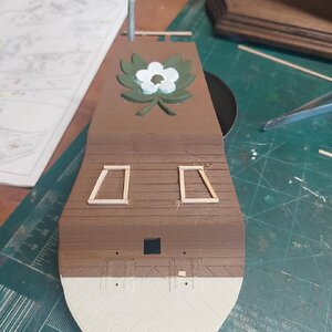

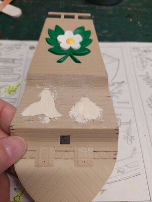

The rework of the stern is a post or two by itself. Where Trumpeter got the idea of the dolphin is just strange, they are wildly wrong had to be removed. using a Dremel drum sander, I lightly sanded off the dolphins, windows, clamshell and name (no evidence of a name of the stern) most ships did not have name on the stern generally until 1720's or later. After sanding the section down, I put plastruct sheet as backing and filled the openings with putty and let dry for 72 hrs. I sanded it some more then I re-scribed the planks, then using a fine-tooth saw, I drug and scratch some grain effect back in the section. While I can't duplicate the knees next to the windows, the curve is too shallow (and incorrect as well), I could at least frame in the windows similar to the current vessel. The white Hawthorn Flower is correct, Although the current ship has a slightly different design.
Although the current ship has a flush mounted window frame's, there was no way I could do that as it would warp the stern too much, so I had to build the frames on the surface. The last pictures is a white Hawthorn bloom, which the ship did have. before I mount the stern up, I'll trim and detail the flower.

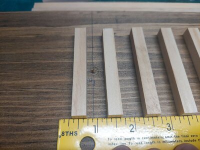

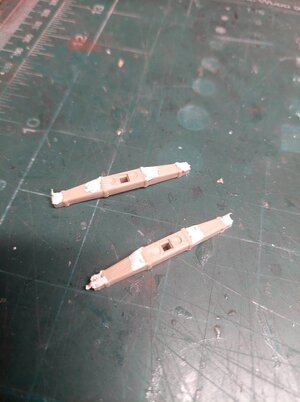

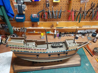

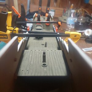

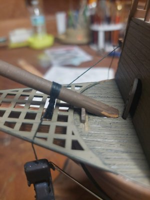

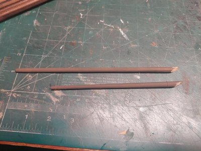

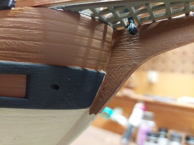

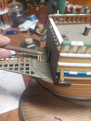

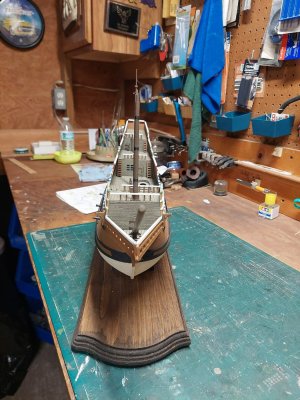

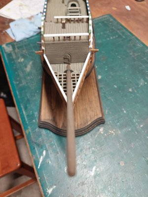

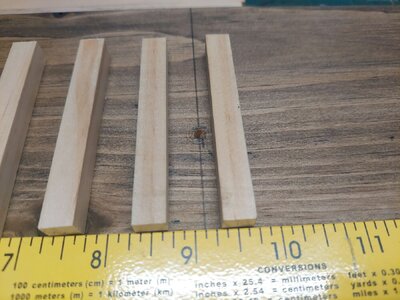

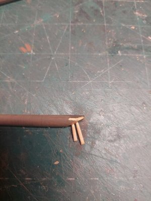

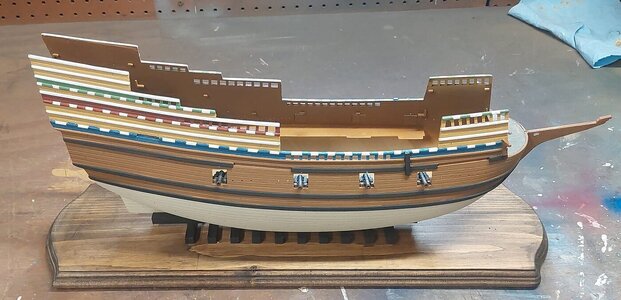

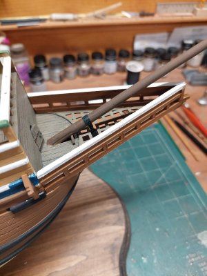

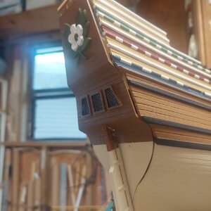

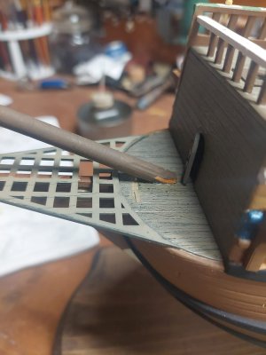

Been a bit since I updated this post, I was tied up with an antique restoration project. I re-made a jib following other builds. I temporarily stepped the mast and generally getting ready to set the shrouds I'm trying to decide if I want to completely remake the masts. I am not happy with the belaying pins (lack thereof) just yet; the scale is off (of course the whole model scale is off as well), I ordered several sizes of pins, but they are either too small or too big, I may just cut sections of round stock. I ordered a book on the rigging of the Susan Constant to help guide where I need to put the pins or if I need to create pin racks and or drill thru the top rail as some ships of the period were. I recut the jib boom to the correct length and stepped it to the forecastle area. The gammoning came out good for once too.
