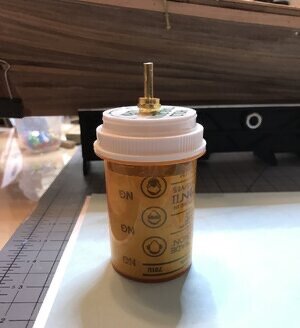

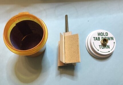

Hah, late to the parade as usual. I diddled around with trying to "customize" blocks a couple of years ago.
An old pill bottle lined with sandpaper, a "paddle" lined with sandpaper, a small brass rod and a TV coax cable connector for a bushing in the cap. I found it worked best when chucked in a cordless drill at a medium speed. After a lot of experimenting I decided the kit blocks were too "ugly" to use whether spun down or out of the box.
