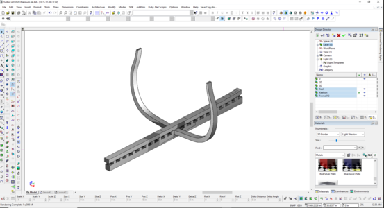

Well, since Phil did say he now owns TurboCAD 2020, I can help him any way that I can. I have tried making frames using TC 2020 and it is a bit of a challenge. I will have to dig up some drawings I did on some 3D frames to see how I did it. It's been a while.

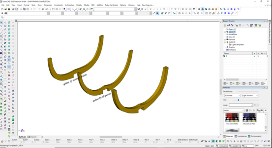

Here are a few drawings I found where I was experimenting with Bezier by control and Fixed points.

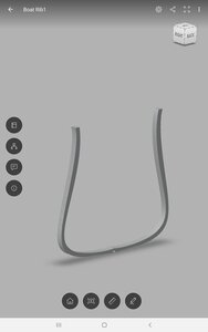

After looking at your 3D drawings, l tried freehanding a boat rib in Fusion 360. Worked pretty well for what it was.
