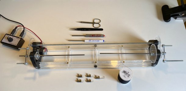

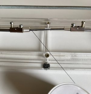

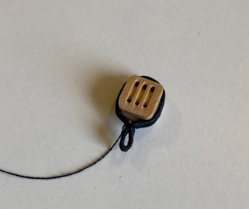

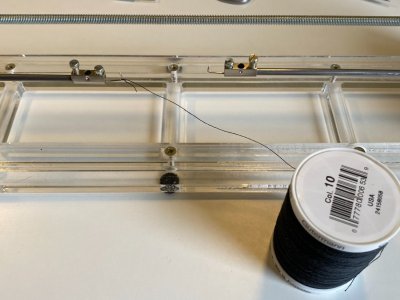

I developed a process that I would like to document here so I do not forget how I did it. It can be useful for someone too. I use Domanoff serving machine for this work. I have quite a few pictures to upload. This will be done trough many posts. Please refrain from comments till I am done with this tutorial. Below is what we are going to use.

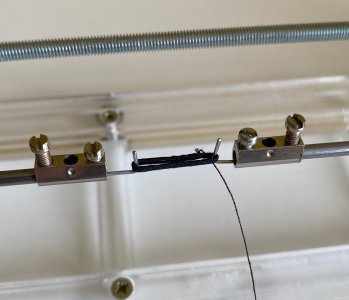

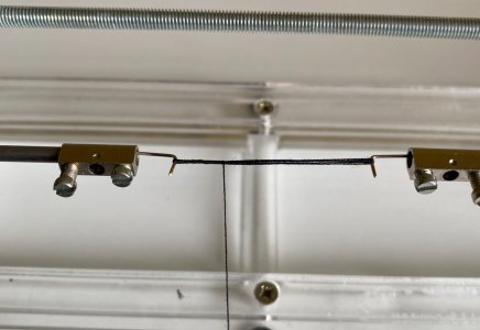

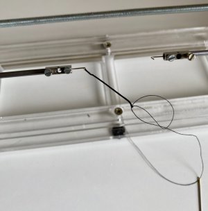

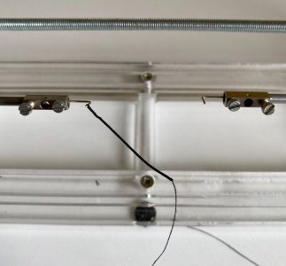

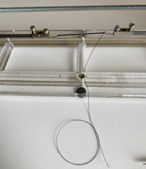

Wrap the thread several times over the hooks. I did this 6 times. Start serving this from left end. At the start keep thread very tight to the hook. Serve up to right hook. Tie the thread with an overhead not very close to right hook. Cut of the thread from spool leaving long end.

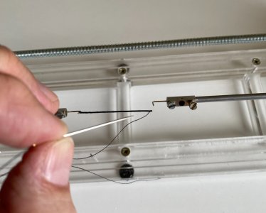

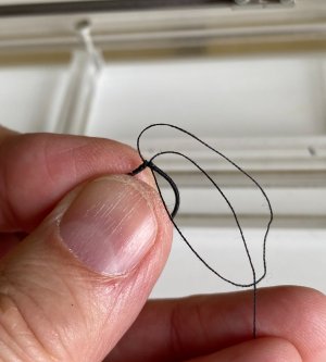

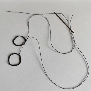

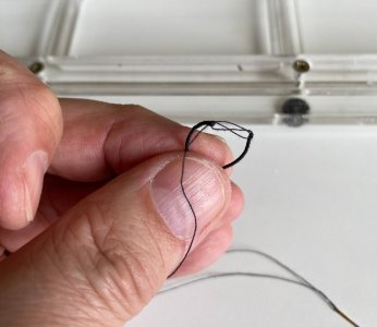

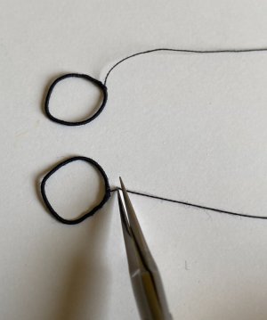

Remove one end of strop off the hook. Using needle tie the thread through strop little hole and tie with one overhead knot. Remove strop other end off the hook and using needle tie both strop ends together finishing with one overhead knot. Now you should get a complete strop with long thread end.

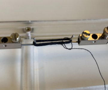

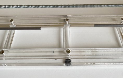

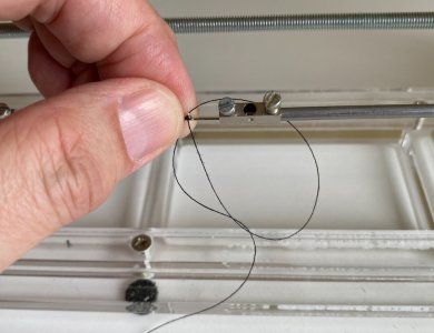

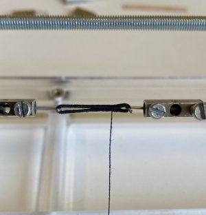

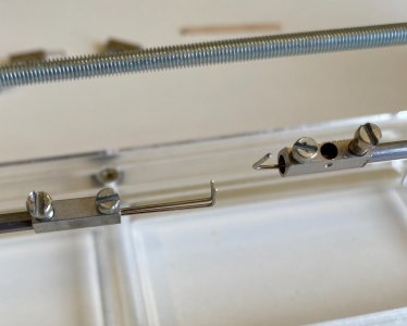

Change for stronger hooks. Put both strops on the hooks. Stretch tight. Tie both strops together with one overhead knot. Make a few turns and again tie with one overhead knot. Take strops off the hooks and wrap them loosely over the triple block.

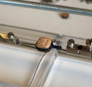

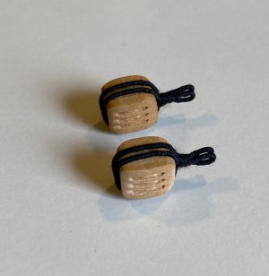

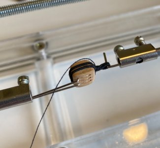

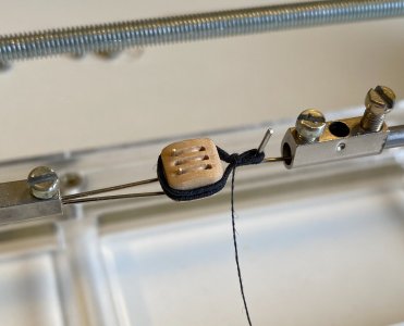

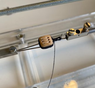

Change the hook on the left with my patented double hook block holder. Put block on the hooks as shown. Tighten the strops on the block using overhead knots and some thread turns.
