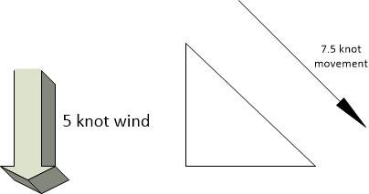

1 Can a sailing ship move faster than the speed of the wind?
2 I have heard that sails act as an airfoil so that the sails are actually pulling the ship rather than pushing it. Is that true?
1. Air current and sea current are different things, they act independently. Yes.
2. The wind pulls. The wind creates a forward aerodynamic force and creates ''aerodynamic thrust''. At least that's what they taught me.
The principle of the airfoil works by curving the wind. The side facing the wind is a straight line, while the outer side is curved. That means that on the outer side the speed must increase as it has a longer distance to travel. This then creates a vacuum (slightly lower) pressure on the outer side, thus the term pulling along. Same principle as on an airplane, it is sucked up into the sky.
Racing airfoil catamarans can sail over twice the current wind speed (not in the same direction, of course). See article How SailGP’s foiling F50 catamarans sail so much faster than the wind. A current, sleek sailboat has a theoretical maximum practical speed of SquareRoot(Length)x1.34, or 9.5 knots for a 50 foot long boat. Increased friction gets too high when this value is exceeded, even with higher wind. Hulls of tall ships as we know and build them are much slower (clippers and such excepted, of course).

1. Yes! It is simple geometry and physics.
2. Any six year old racing sabots (a six foot catboat) on the coast of New England is an expert in this subject.
3. You can't get a sailboat to move an inch without proficiency in this subject.
