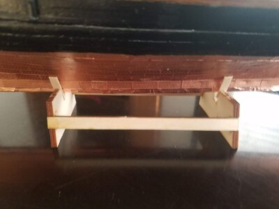

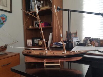

Building mamoli model yacht america, only my third build. Just starting the rigging. The stand which came w the model is quite unstable making it difficult to work with. In addition stand is a poor fit. Think my best bet is to replace the stand before continuing, but would like any suggestions or help. See the photos. Would appreciate any thoughts.

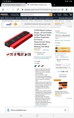

Use a contour gauge to copy the hull shape. Then cut a cradle to match.

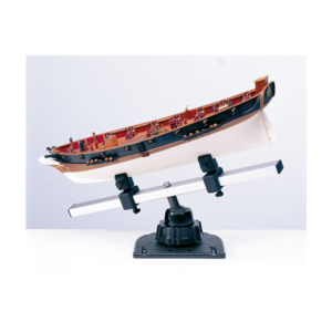

Since my Bluenose model has a full length keel extending about 3/8 inch below the garboard rabbit I have continued to keep it in my Amati Keel Klamper (from Ages of Sail Shop for $79.00) adjustable base with the bottom ball fitting and 18 inch long aluminum tubular upper bar. Except for rotations exceeding about 110 degrees on the longitudinal axis and 30 degrees pitch it securely works well. By staging my work I should be able to minimize problems in rigging with almost full access wherever I want it using both my sit-down desk chair and tall adjustable height shop drafting stool. Rich (PT-2)

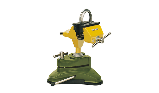

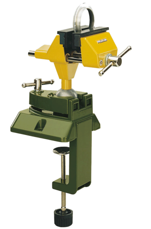

Like @PT-2 mentioned a keel clamp is working often very well
In principle the same way is with a vice like this one from Proxxon with protective covers

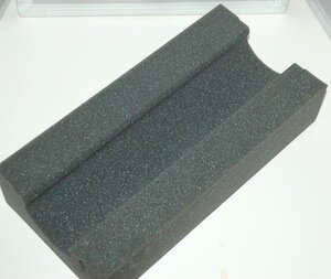

another possibility is some foam cradle, like this one
but you can easily use soem foam material you can find in any drug store and bring it to your size

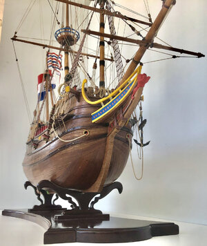

I understand your situation.
I never use the model stands, to me, the rob the model’s elegance.
I always do what Philski suggested.
Mark on your hull where you would like to have your bases.
Use a contour gage and transfer that to a blank piece of paper. Glue the traced paper to a good piece of wood, (Mahogany is excellent), and add your own design to it.
I also add a piece of brass rod to the base where the keel seats on and a corresponding hole in the keel. That would make the model stay in the base whenever you want to move it.
Here is a sample of one of my bases.
