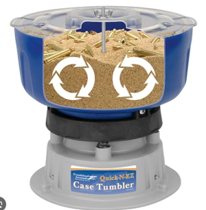

there are also vibrating devices we call tumblers. We use them for cleaning brass when we reload ammunition. They are filled with bits of chopped up corn cob (or other types of media) and have a polishing compound added. But this would not remove the flash.
