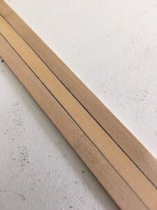

I was watching a you tube video on timber marquetry, and stumbled across a great idea. For highlighting the caulking seams on planks you can use a black graphite pencil lead.

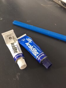

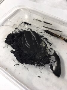

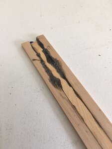

But instead of marking the side of the plank with a pencil, you mix the crushed graphite pencil lead with glue.
I have been experimenting with white pva glue and 2 pack epoxy glue, and both work superbly. I used one of those thick builders pencils in the picture. Just split the pencil open and extract the lead.
Great results Brian Thumbsup The caulking looks like a true black rather than the dark grey you get using a normal HB pencil on the edge.I would say the one important thing with these techniques is that the plank edges need to be perfectly true and smooth.Some of the "furry" kit planking would result in a black line that waved about all over.

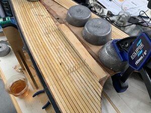

Hi Brian, So you cleaned up the planks with Brynes thickness sander, how would you clean them up when they were laid on the deck? Would that just be hand sanding or with a scraper? Cheers Tony
Hi Tony,
thats a difficult question to answer, but I think it would be best to laminate the deck planks onto thin plywood and sand it before fitting to the model.
Hi Brian, I am sure that would work well. I still lay my planks using the black paper/light card method, that is stuck onto my board prior to cutting the individual planks, then laying them on to a ply sub deck using pins and epoxy then using a sanding block and a scraper to level the boards prior to applying more clear epoxy to seal everything from water as my craft all need to sail. Regards TonyIMG_0362.JPG
