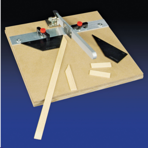

I would not wet planks for cutting. It softens them, but if you don't use a very sharp razor knife, you will crush the fibers rather than slice them, like cutting spaghetti with a hammer. The cut ends will be frayed. For cutting to length, a razor chopping board is very good and you have leverage to chop through planks hardened by CA. I use this chopping tool, and it is strong and very precise. You can hand sand small sticks to adjust them to their final length if required.
Micro-Mark Chop-it $39.95

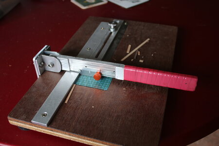

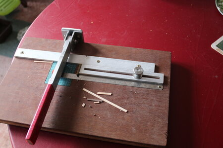

If you have some rectangular aluminum bar stock, a drill press, a board and some machine screws and wood screws, you make an even better one. I glued a board into the left side to make it a bit longer. Even though the chopping bar on the Micro-Mark is quite stiff, you still have to press straight down so cuts are precisely where you want them, especially for cutting hard walnut that is thicker than 5mm thick, of the cutting edge will deflect a tiny bit to the right. A bar supported on both sides will cut straighter. I'm talking about the smallest of improvements here. The Micro-Mark cutter is fantastic.

I've got one like this , but I built it myself, yes I'm guilty of 'plagiarism!' Much better than the all plastic, adjustable one I bought for £10.
