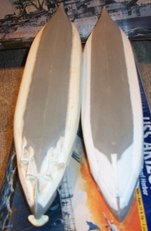

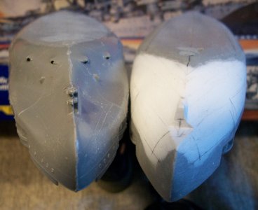

you are not the only 1 as i started the Pennsylvania which is the 1st of the 17 OBB ships at about 2008, i've got 13 ships started of the 17 but none finished & the Pen is now the mk2 version as to much work to correct the mk1 version.

Jim, the mk1 is not a product but the 1st version of the Pennsylvania that started the whole process then over time i started the mk2 version that has more correct torpedo bulges & stern but the stern has to be reworked as in more sheet plastic strips glued to the concave stern to bulk it up before shaping it to the correct shape. & correcting the shape of the armor belt at the stern area. wooden decks i don't use as they are out of scale at 1/429 scale. got most of my 3d printed secondary guns from 3d model parts before covid hit that might have put it out of business which is to bad. got 2 3d printed kits of various parts plus a replacement kit due to 2 boat issues a couple of years ago off ebay that are on sale again. https://www.ebay.ca/itm/126544549489
inverted stern view, left is mk 1 Pennsylvania & right is mk 2 Pennsylvania.JPG
