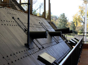

Cairo sinks following the explosion of a mine December 1862
The wreck was partially recover in 1965 and is now exhibiting at Vicksburg National Park.

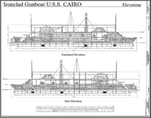

A beautiful model was made by Gene Bodnar at 1:48 on commission if you are interested here is the link that I will regularly consulted.
The kit that is the same scale as my 2 previous (USS Monitor and CSS Virginia) is 1/192
By cons it is a kit that received a beautiful facelift 2016-2017
And at first glance seems excellent

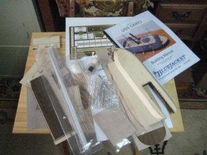

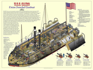

The kit includes a solid form of lime tree whose finish looks excellent in 2 pieces of laser cuts a PE sheet, styrene stem, white metal piece and wooden stick.

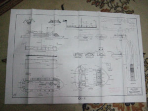

An instruction booklet (much better than the previous 2) and a descriptive plan that is very good.

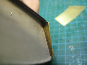

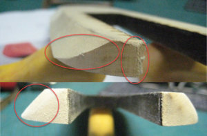

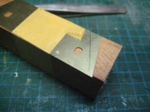

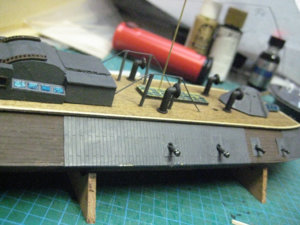

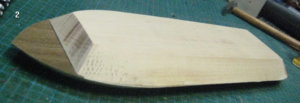

The hull come in 2 pieces that are laser cut.
The bottom piece requires a sanding to round the back and corrected an imperfection beside that it is perfect
1

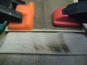

There are 2 pre-engraved plates for the bridges the first mounts under the pillbox and does not require any adjustment and they are very good with fine engraving
2
By against the second one that arises on the casemate to give me a little problem
The angles of the matte box are not correct at the bow and stern and I must make a 3-4 and 5 correction for the prou and 6 when corrected for the stern

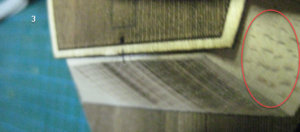

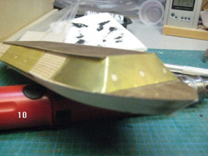

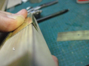

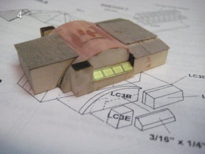

Small advance

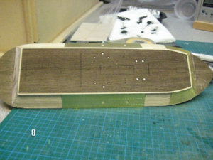

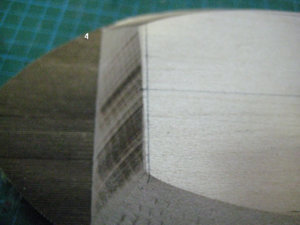

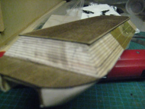

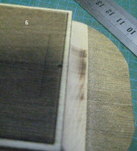

After laying the bridge of the casemate (1) poses cutouts
Problem of the beginning that of the stern is not correct and required a big correction 2 and 3

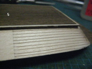

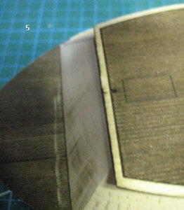

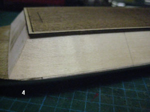

Part of the casemate has no photo cut and there is nothing in the instructions to make a pattern so I decided to simulate the wood curling 4, 5 and 5a
The other photos cut for the side of the casemate have landed accurately without problem 6 and 7
Here is the casemate is ready to receive details 8 and 9

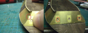

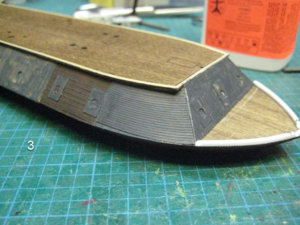

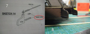

Second problem
After adjusting the plate of the barrel the barrels are no longer aligning
Just a question of remaking the holes correctly 1-2
Start of painting 3

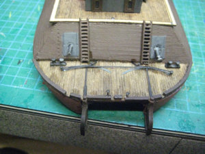

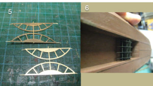

Construction of the casemate of the paddle wheel 4 and paddle wheel barely visible 5-6
Rudder 7-8

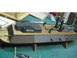

Installation of the accessories of the casemate 9

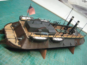

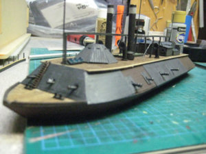

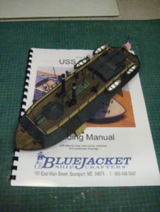

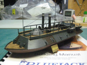

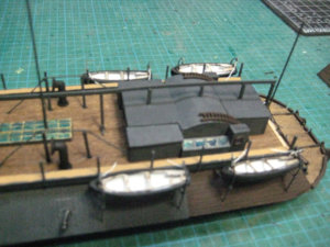

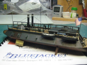

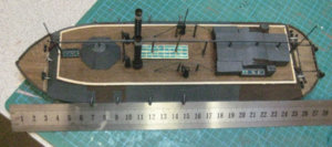

Last pieces and finish
it is a good model
Far better to the other 2 (Monitor and Virginia)
Apart from the plate of the front the rest has been superbly well
Proper instruction and drawing
The only reserve is the scale 1/192 I find it too small
I think 1/90 would be great and give the opportunity to look after the details

Great appearance of these three models...... and very good kit-bashing, especially in this small scale - Many thanks for sharing these 3 builts
