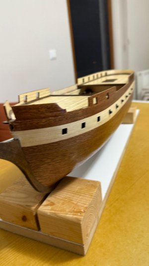

Really beautifully planked. It turned out really nice!! Great work. Thumbs-Up

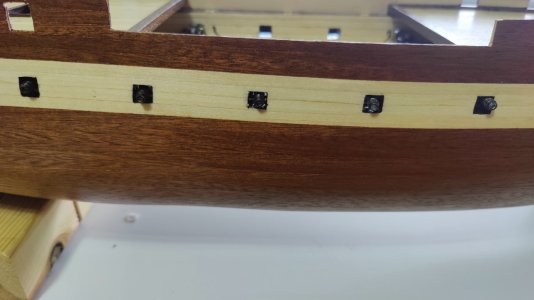

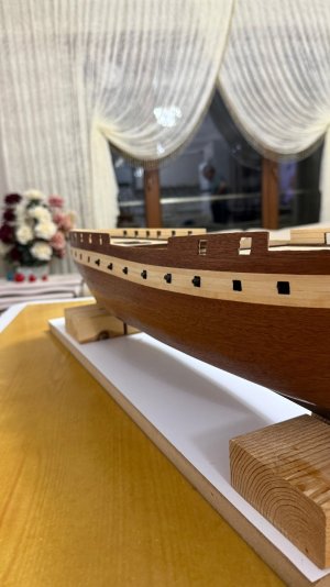

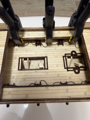

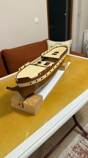

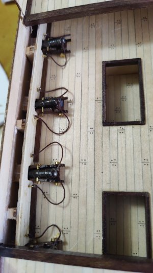

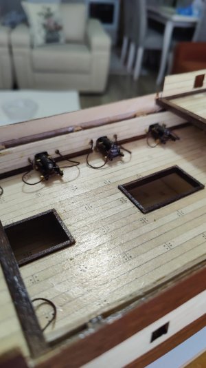

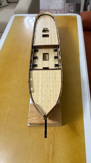

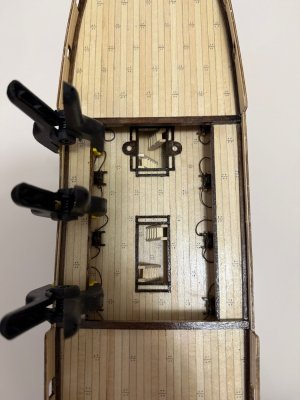

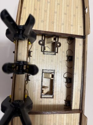

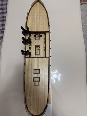

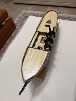

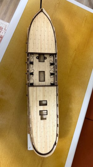

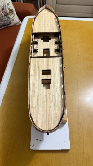

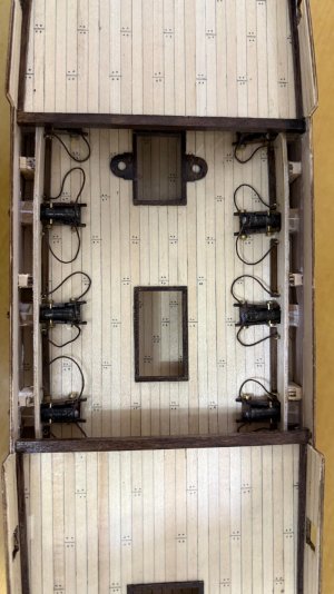

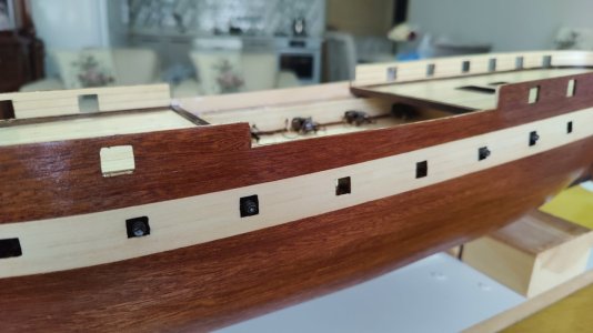

The placement of the lower hull guns and gun carriages has begun. I had a hard time fixing the upper decks because of a mistake I made at the beginning regarding the placement of the lower hull forward and rear guns, but so far it's going better than I expected...
I make sure the guns are level. Also, the plan stated that the gun mouths should be 9 mm outward. I took my measurements accordingly.

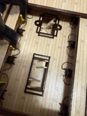

Actually after placing the lower deck guns and gun carriages, I actually needed to fit the upper deck. However, I encountered this difficulty because the plans lacked sufficient explanation. However, I found a suitable solution and placed the gun carriages. This seems to indicate that it's essential to research all the literature before starting to build the model.

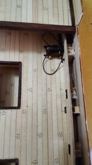

I couldn't decide whether to make a rope around the warehouse or use chains.
artesania, shown as thread on the plan
The only problem is that there are not enough gaps in the Artesania plans. That's why I'm trying to move forward by doing research on the forums.The most detailed plans I've seen on this subject belong to occre.
Thanks for posting your photos. They bring up a question for which I cannot find an answer. The breech ropes are all black like they are tarred on your model. Was this done on some ships at some point in time? I have never seen tarred breechings but as it is not handled by the crew very much compared to the running out and train tackle, it really might not cause a serious problem.
