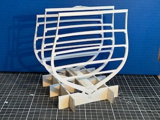

USS Constitution 1797 Cross Section (Model Shipways), by Strand

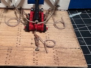

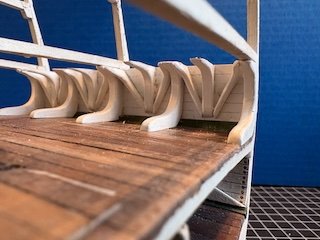

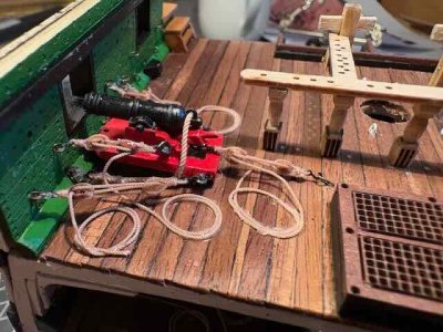

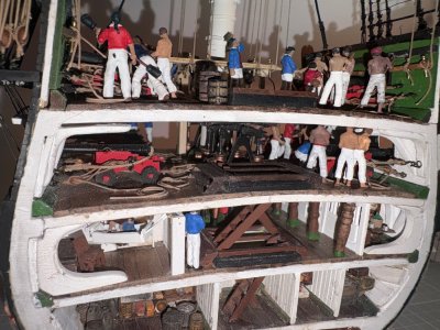

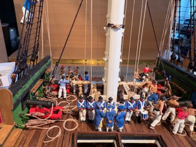

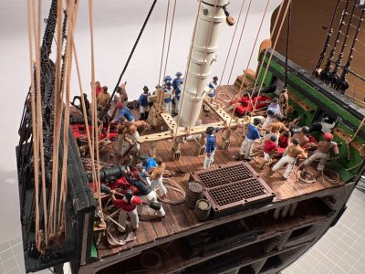

The Spar deck is finished and I have started to equip it with the necessary equipment.

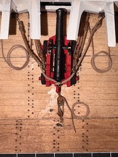

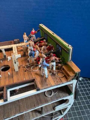

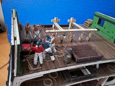

Actually, I should have planked the hull first, but as everyone knows by now, I love my little 1:76 crew members and I couldn't resist installing two carronades and manning them.
First of all, carronadas alone...
Then with the corresponding staff:
followed by the second carronade and its gunners...
And all this just to put off my first big challenge, planking the hull.

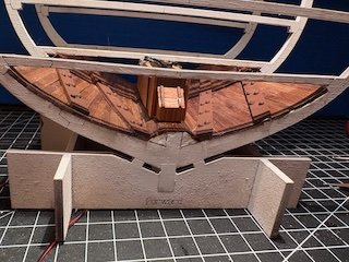

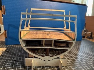

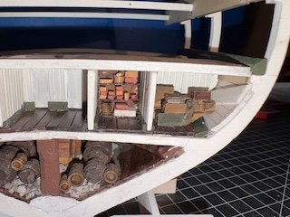

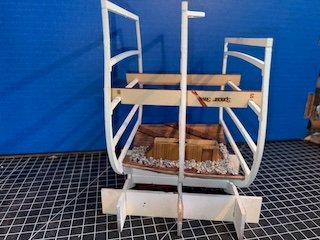

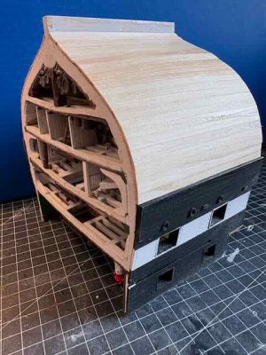

After deciding to get into shipbuilding, I started with the cross section of the USS Constitution to get a feel for wood, gain some initial experience and attach the first, albeit super humble, planks to the hull.
And as far as I can tell, it worked out quite well.
My fear was unfounded.

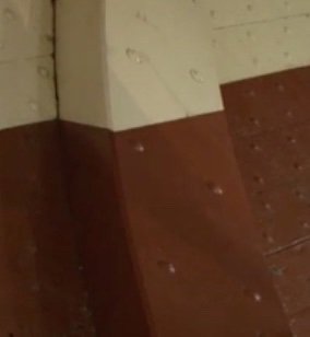

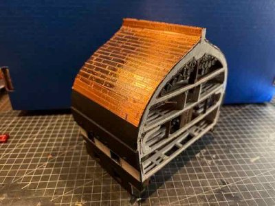

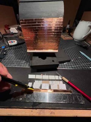

However, I have the most respect for copper plating, as I have no experience with it whatsoever and this copper foil seems very fragile. I hope it doesn't turn into a complete mess.
The copper wasn't so bad after all. But that only applies to my expectations. Perhaps the result isn't as good as I think it is. In any case, I'm satisfied.
I built a device where I could cut the foil and attach the rivets.
And once again, I took the liberty of a model builder and only used the rivet rows very sporadically. In my opinion, and I'm really no expert here, the many rivets look too dominat on a scale of 1:76.

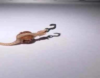

Another completely new thing for me. With the guns and carronades, I was able to work with blocks and ropes for the first time and am constantly improving.
I quite like the lad, but again, that's not an expert opinion, just my humble opinion.

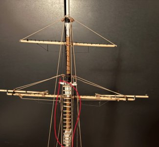

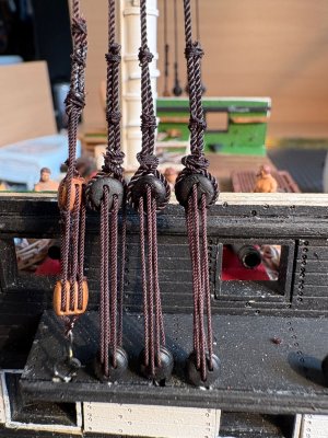

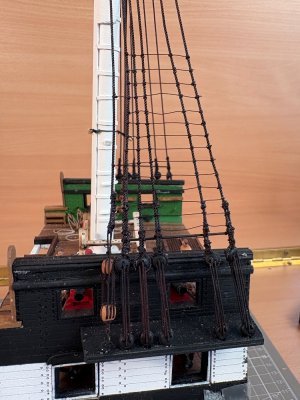

I started with the shrouds; everything to do with ropes and blocks is completely new to me.
I've bought a "few" books on the subject...
And then we were ready to go.

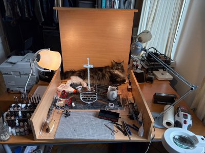

The assistant has already arrived and is waiting patiently for his assignment.
By the way, this is my workplace, a box with a lid that can be closed.

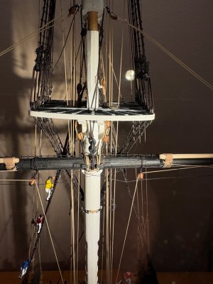

The first shrouds were installed, the first knots tied, the first ratline knotted – all completely new territory for me. But it's fun.

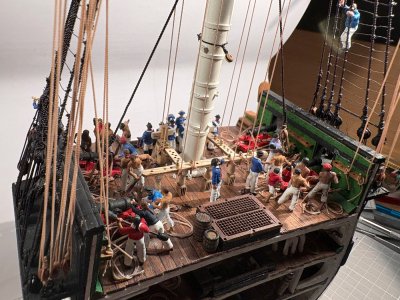

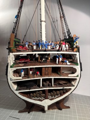

And finally, a few impressions of life on the USS Constitution
It was a wonderful first project that left me wanting more.

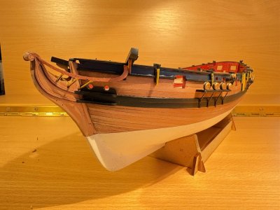

So I immediately started my second project, the HMS Flirt from Vanguard Models. This will be my first real ship.
I can already show you a photo of it...

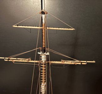

I have the same kit and will hopefully take it out the box in '26. I have a few questions, where did you purchase the figures from? I'll like to purchase a few for my model as well. Also, I noticed you have a Jacob's ladder above the fighting top or am I not seeing the pictures clearly; was that called for? I've built this kit before back in 1997 (gave to a charity auction) and I could not remember if this was part of the rig? I circled in red. Thanks

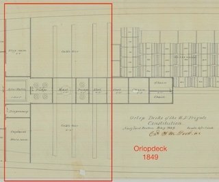

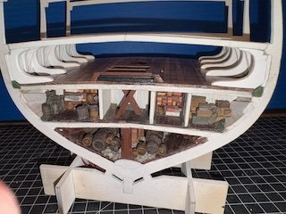

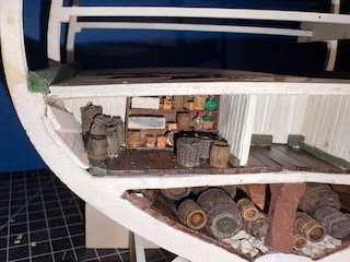

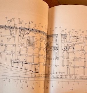

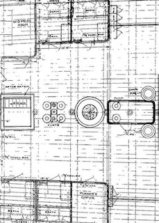

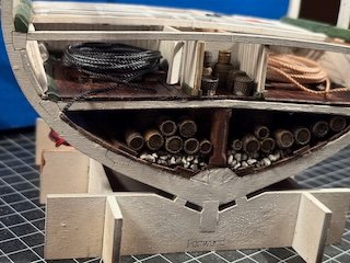

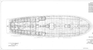

The next step will be the berth deck. I will once again go my own way and design the deck according to old plans. I will use a plan for the restoration of the ship from the USS Constitution Museum in Boston as a template.
They have wonderful plans on the museum's website under “Modeler Resources.” A treasure trove for model builders.
And here again as an image detail.

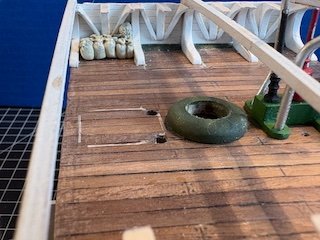

I would also like to show some hammocks to document the humble life of the sailors.
I assume that these will pose quite a challenge for me in 1:76 scale. Perhaps one of the readers of this building log has already done something like this or has an idea how it could be done...
1:76 hammocks.jpg1:76 scrap hammocks.jpg

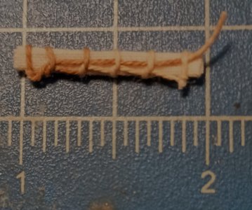

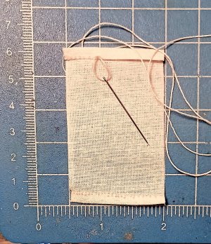

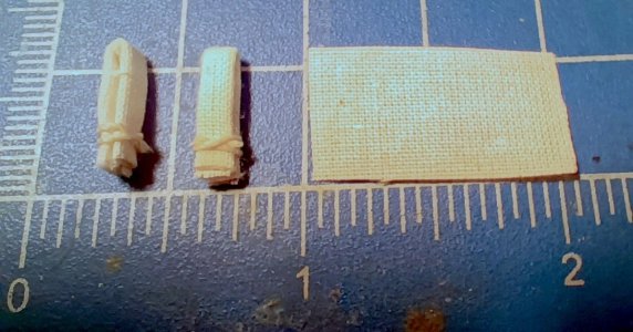

I've been experimenting making 1/76 lashed hammocks to fill the hammock rail. They don't need a lot of detail for that purpose.
Lashed up 1/76 hammock ready to be stuffed into hammock rail.
(A finer weave cloth and smaller thread are needed for 1/76 scale.)
1:76 lashed up.jpg

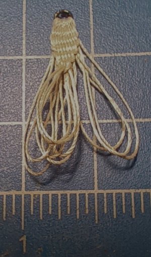

I've been researching U.S. Navy hammocks. I found a wonderful youtube series by woodworker Nate Large where he shows how he recreated his father's world war two hammock, which includes making the clews that supported the hammock on each end.

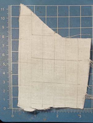

I made a 1/24 scale hammock just to get a feel of how they were made and stowed.
Sewing up muslin prototype
1:24 hammock-1.jpg

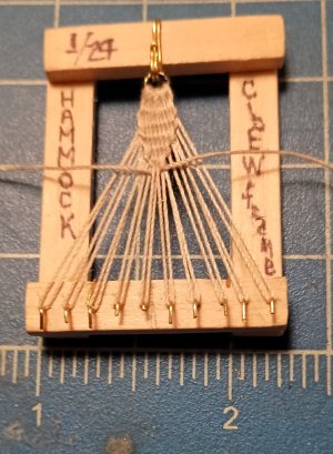

Clew frame in action
1:24 clew frame.jpg

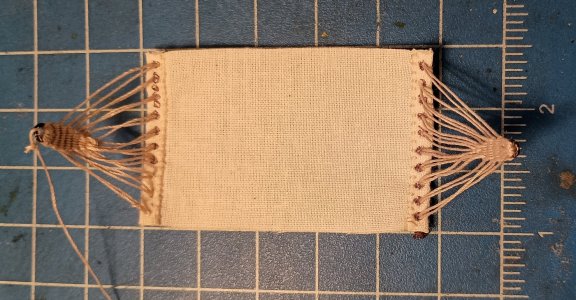

Finished clew in 1/24 scale (squares are 1/2 inch)
1:24 clew.jpg
Finished hamock with clews installed
1:24 hammock.jpg

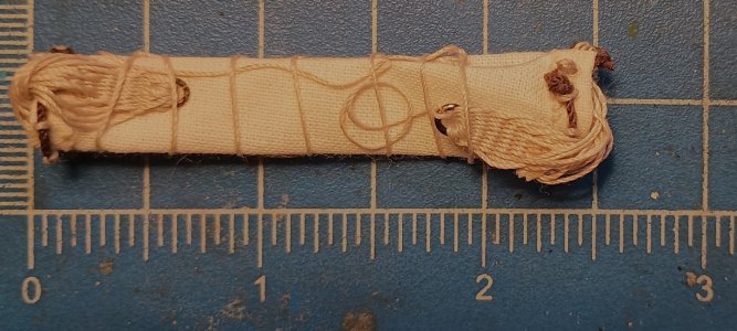

Lashed up hammock would be folded in half, then stuffed into hammock rail.
1:24 lashed up.jpg
Hope all this helps you, Strand.
