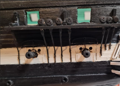

Good job, Jack. I hate to say it, but the deadeyes are upside down. I hope you can still turn them.Port side mizen channel and chainplates. I think my soldering is improving a little. I wasn't cleaning the surfaces enough and not putting enough flux.
no worries. they are loose. I didn't adjust them yet. lolGood job, Jack. I hate to say it, but the deadeyes are upside down. I hope you can still turn them.
Thank youNicely done, Cap'n Sparrow.
thank you.Looking good Jack.
Way to go Jack.well starboard side mizzen and main mast chainlates are done. Using sandpaper to clean the surfaces then adding a lot of flux seems to be the solution. Oh and I keep my iron at 500 C. It works like a charm
