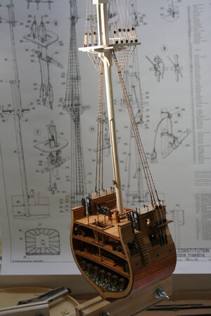

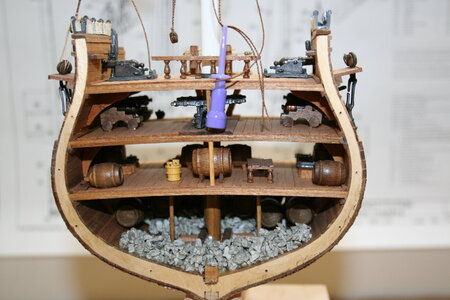

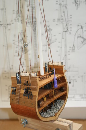

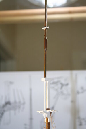

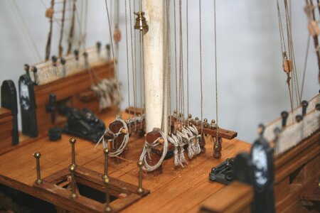

After 35+ years stored in a box and now my having a work area that I can leave the project set up full time, it was time to unbox and figure out where I left off on the project. The only damage was to the top 6 inches of the mast that became warped sitting in storage. In an attempt to straighten it out, of course, it broke. I eventually glued the section back on and fabricated a support work to strengthen the joint. The following are some pics from the unboxing. As I previously noted, this is my 1st build so I've decided to use the project as a platform to develop / improve my skill sets.
I'll post a few more pics to show where I am currently in the project. Because I have other projects (honey-dos) as assigned by the Secretary of the Navy, my progress is slow... but is still considered progress.

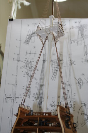

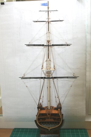

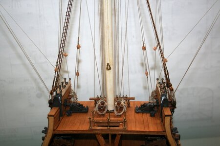

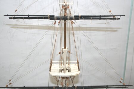

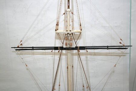

After re-familiarizing myself with the plans / worksheets and inventorying the kit, I started in on the shrouds and ratlines. When I first started this project, there was no Internet, and thus no forums, or YouTube videos to learn modeling techniques and creative ways of doing things. My how things have changed. So I'll express my sincere thanks to those modelers who generously give of themselves to provide help to those of us that are just starting out and facing the same hurdles.
Next up is the pre-work on the yardarms and deck. Thanks for your support

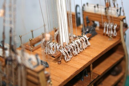

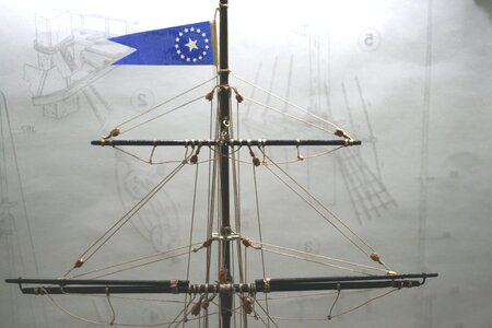

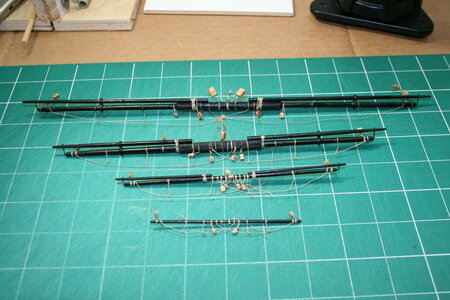

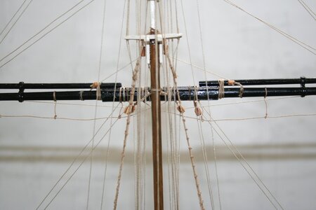

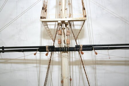

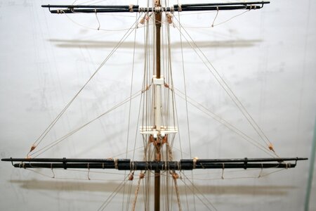

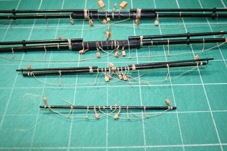

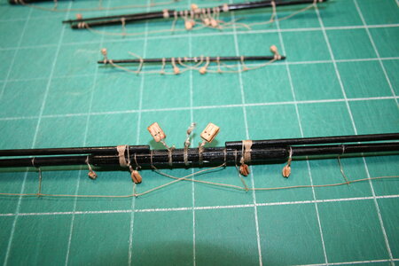

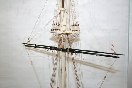

Following the advice of others, I prepared the yards and spars before attaching them to the mast. It became very clear from the start that this was indeed the way to go. I did not do the full rigging of them (i.e. all the down lines) as it would be a bit too confusing for me, a first timer. During the process of attaching the blocks and stirrups, I tried different techniques (trial and error... a lot of error) and learned not to use the super thin CA as it wicked up the lines and made them glassy looking. For me, I found tying a clove hitch, square knot, or granny knot and securing with a dab of diluted PVA, or thick CA worked the best, but I also realize I need to improve on my technique. The following photos are the results.

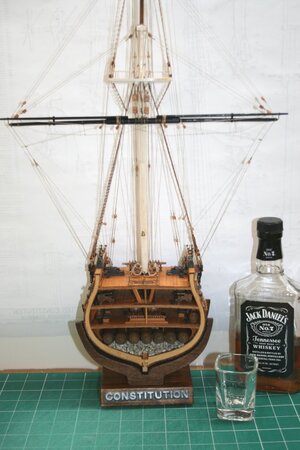

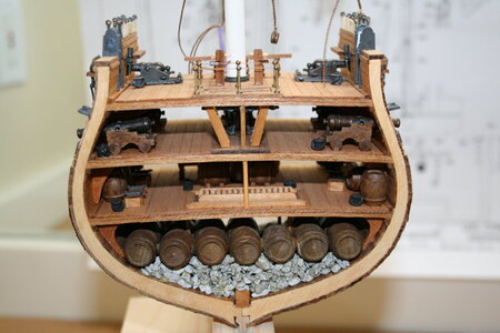

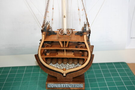

When I started this project 35+ years ago, I never gave much thought to painting the various accessories such as the gun carriages, etc. Don't know why except that the plans didn't call for it. Had S.o.S been around back then, I would have done things differently. I also chose not to paint the hull as my wife liked the looks of the natural wood and because she bought me the kit... well you all get the idea. I did apply several coats of acrylic matte varnish to it. Here's some photos of the finished hull.

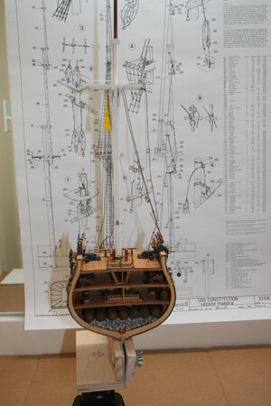

Being that this was my first go at rigging a model ship, it was a bit overwhelming looking at the plan sheets with only minimal instructions. Before moving forward, I deciphered the build order and followed each line from beginning to end step by step and put the results into an Excel spreadsheet. For me, this helped immensely. The following photos document my attempt.

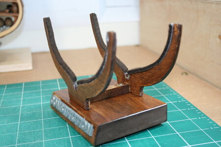

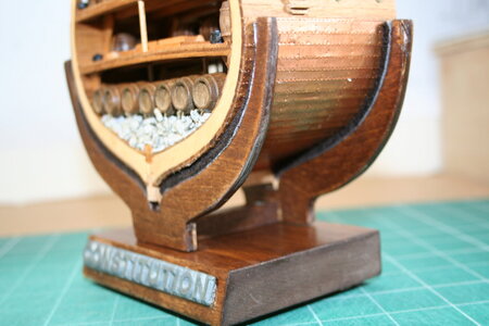

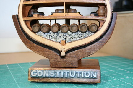

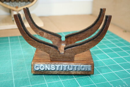

The kit provided a base and nameplate, but no accessories to mount the hull to the base. I looked at the brass stand offs, but didn't have the confidence to drill into the keel after the model was finished to secure the stand offs. Instead I made a cradle to hold the hull in place. Next build I will think ahead as to how to mount the model. I choose not to paint the nameplate as the pewter look was more appealing to me.
